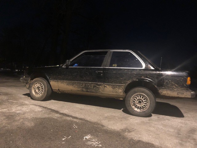

    Meet eDirty my 1985 325e off road toy.
    After a recent shakedown at a local urban off road spot prior to beginning the suspension work.
    Over the past several years I have owned and restored several BMWs but was always worried about getting them dirty, leaving them parked outside, and getting dented in parking lots. For this project, I wanted the fun of an e30 without all the worries of owning a "classic" car. When this particular car fell into my lap, I knew what had to be done - create an off road capable, well-handling car that could be tossed around on Indiana's abundant gravel and dirt roads without fear of ruining it. After a few months of wrenching, getting the car to where it can be reliably driven, and finishing the suspension work, here is how the car currently sits:
    Ride height after finishing the lift last night

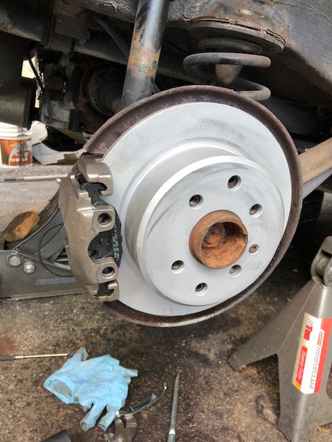

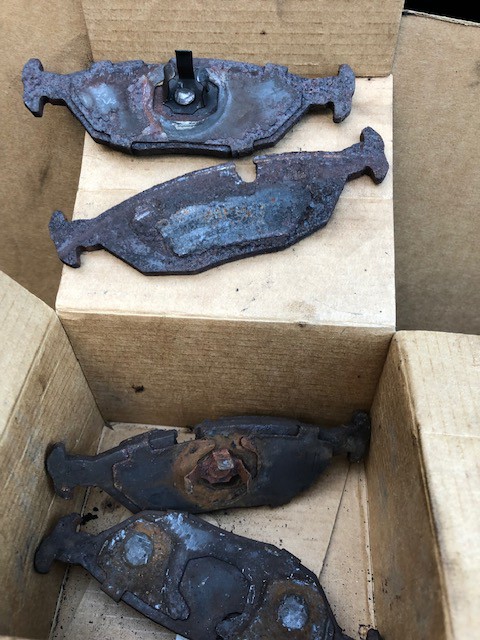

    Once home, I quickly discovered why the e30 did not crank - the battery was dead. The previous owner had apparently disconnected the battery and then shut the trunk which had a broken lock tumbler. This resulted in him being unable to access the trunk and reconnect the battery and ultimately him giving up on the car. After removing the back seat and punching out the ski pass through, I was able to use several feet of extensions to unbolt the trunk latch and it popped open. With a new battery installed, the old gas drained and some fresh gas added, the m20 awoke from several years of slumber. A quick driveway test revealed the rear brakes were seized after years of sitting, so I quickly ordered all new hardware and calipers and installed them.

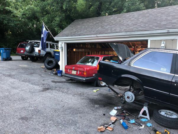

    Needless to say, the rear brakes had been neglected for some time. With the weather nice and the garage full of other BMWs, I didn't mind working in the driveway.
