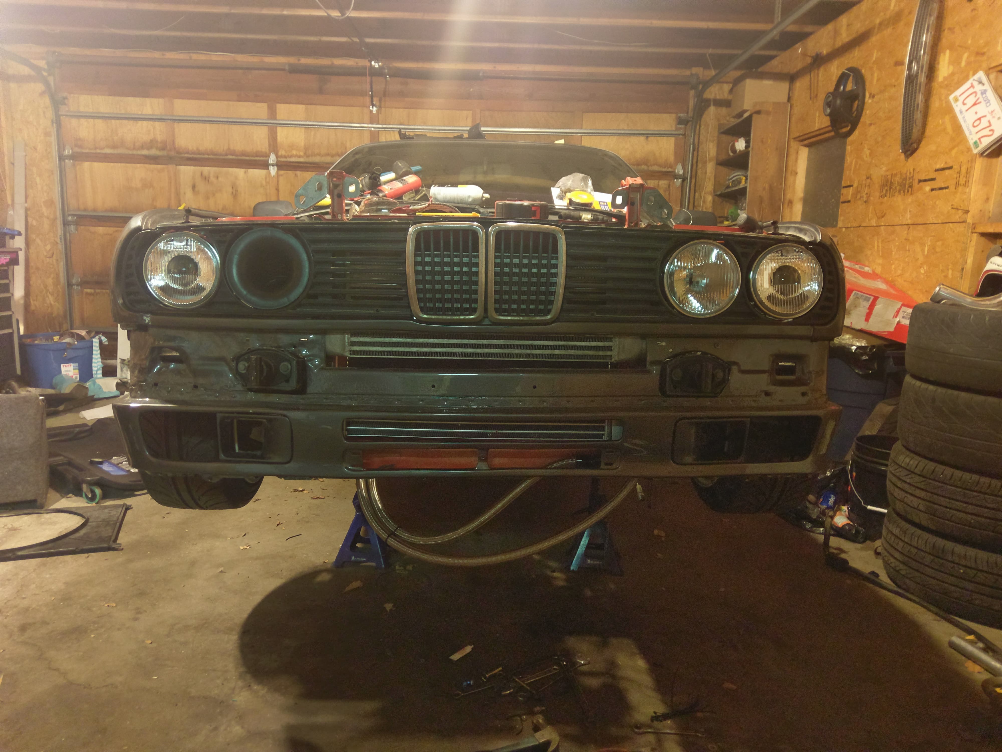

    So I decided to source out all new front end parts. Rad support, headlights, grille, fender and valence and started fixing it.
    I decided to make it a removable rad support since I was doing a turbo build and I was used to pulling engines from the Subaru so I wanted to prepare for the worst!

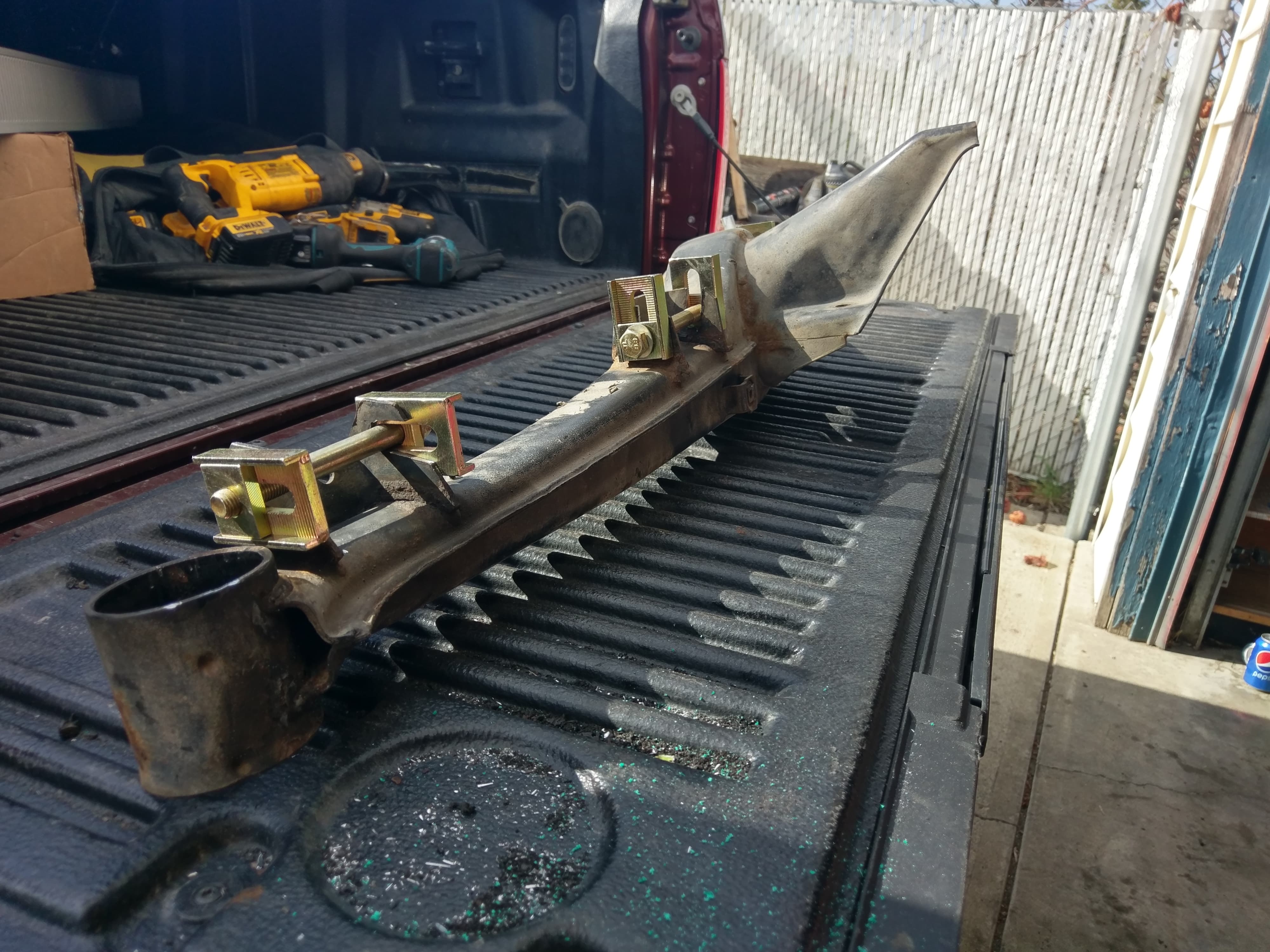

    IE Camber and Toe plates welded in

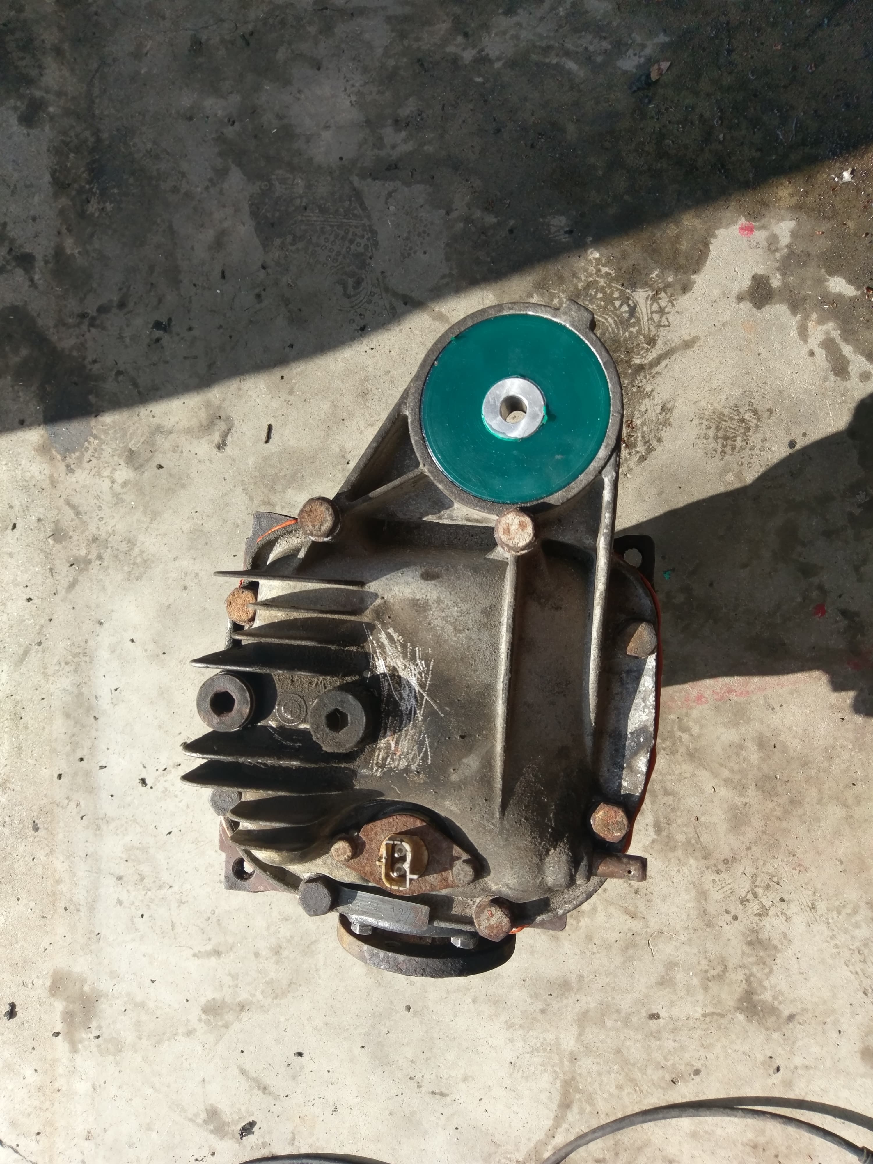

    Full IE Bushing kit (Diff, Motor Mounts, Trans Mount, Control Arm Bushings, Trailing arm bushings)

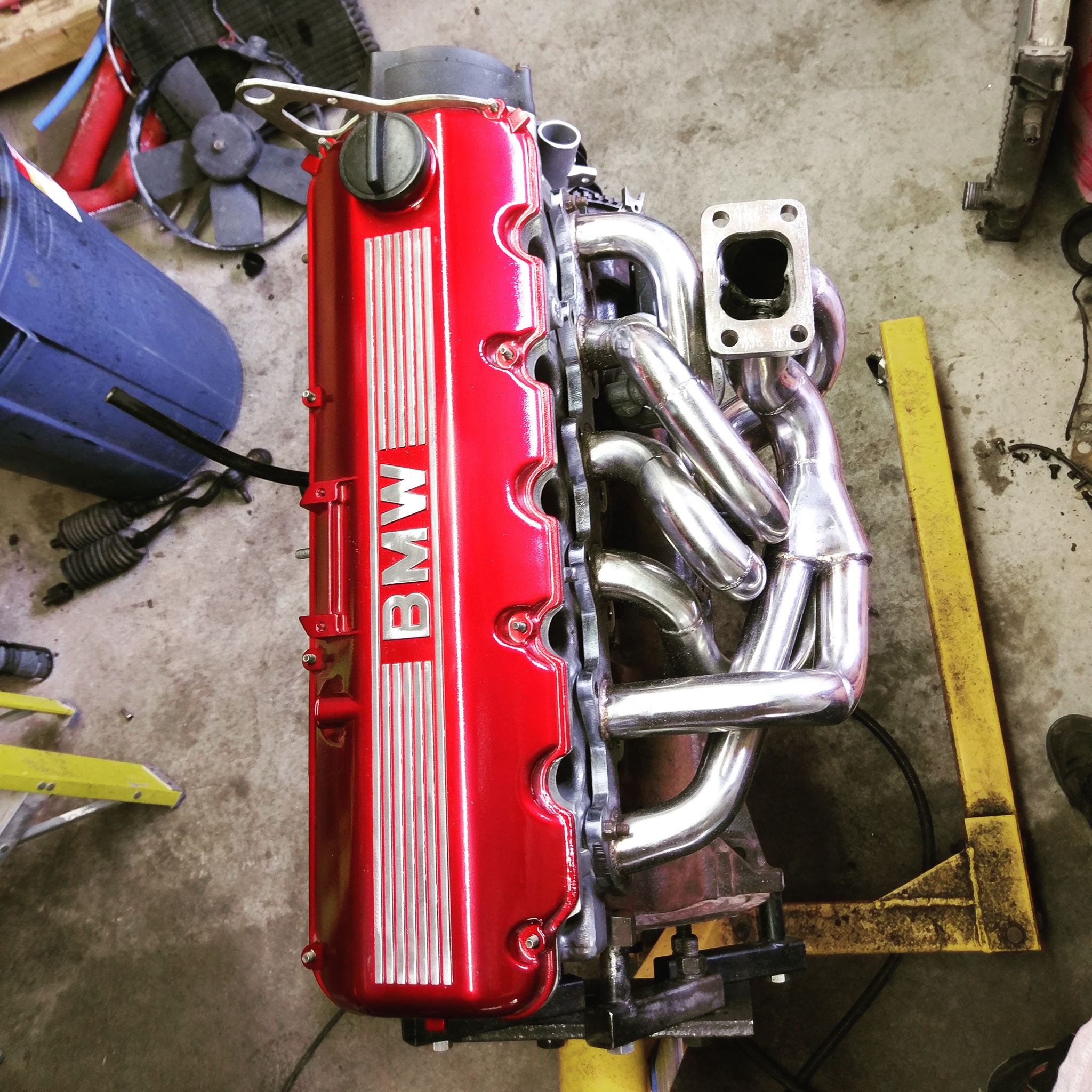

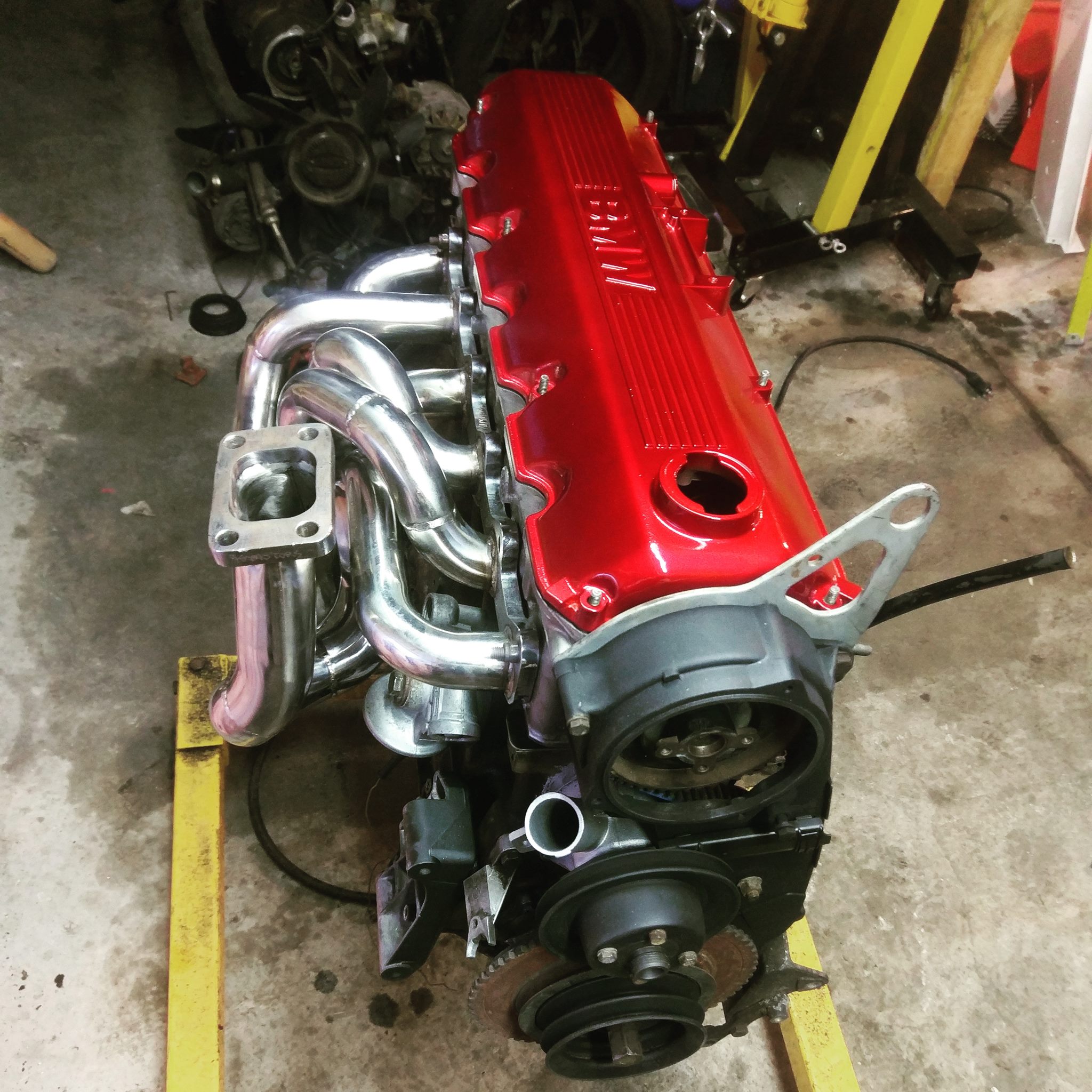

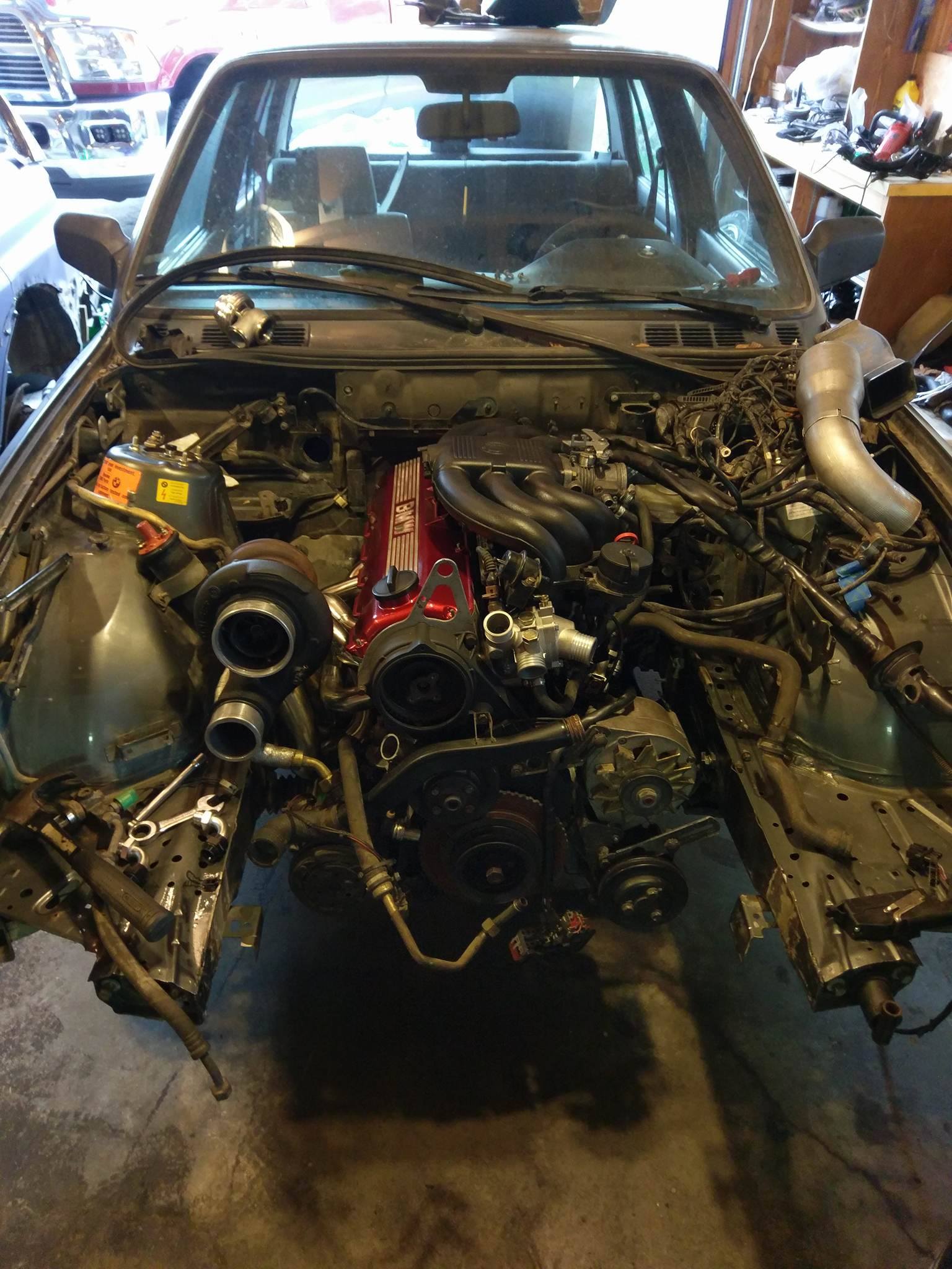

    Decided to refresh the engine a bit before installing the i engine. All new gaskets, Timing components, Water pump, Colt Cams turbo grind cam, lapped valves, check and set valve lash. Check bearing clearances, ARP Studs, and an MLS Head gasket.

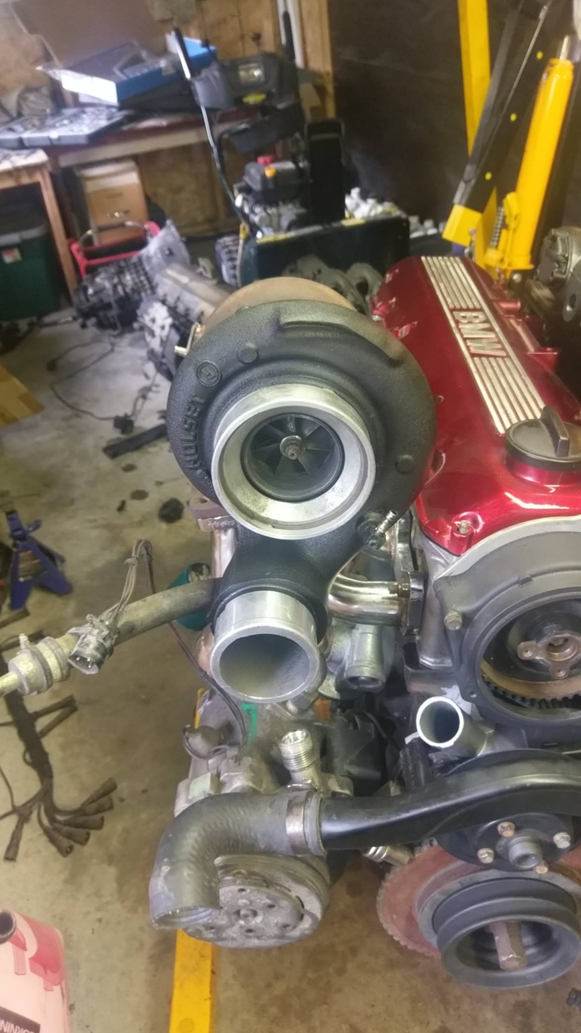

    Paired the newly refreshed i engine to a KA Motors turbo manifold and Holset HE341 turbo. Putting the boost to the ground through a G260 transmission and a Spec Stage 3 clutch.

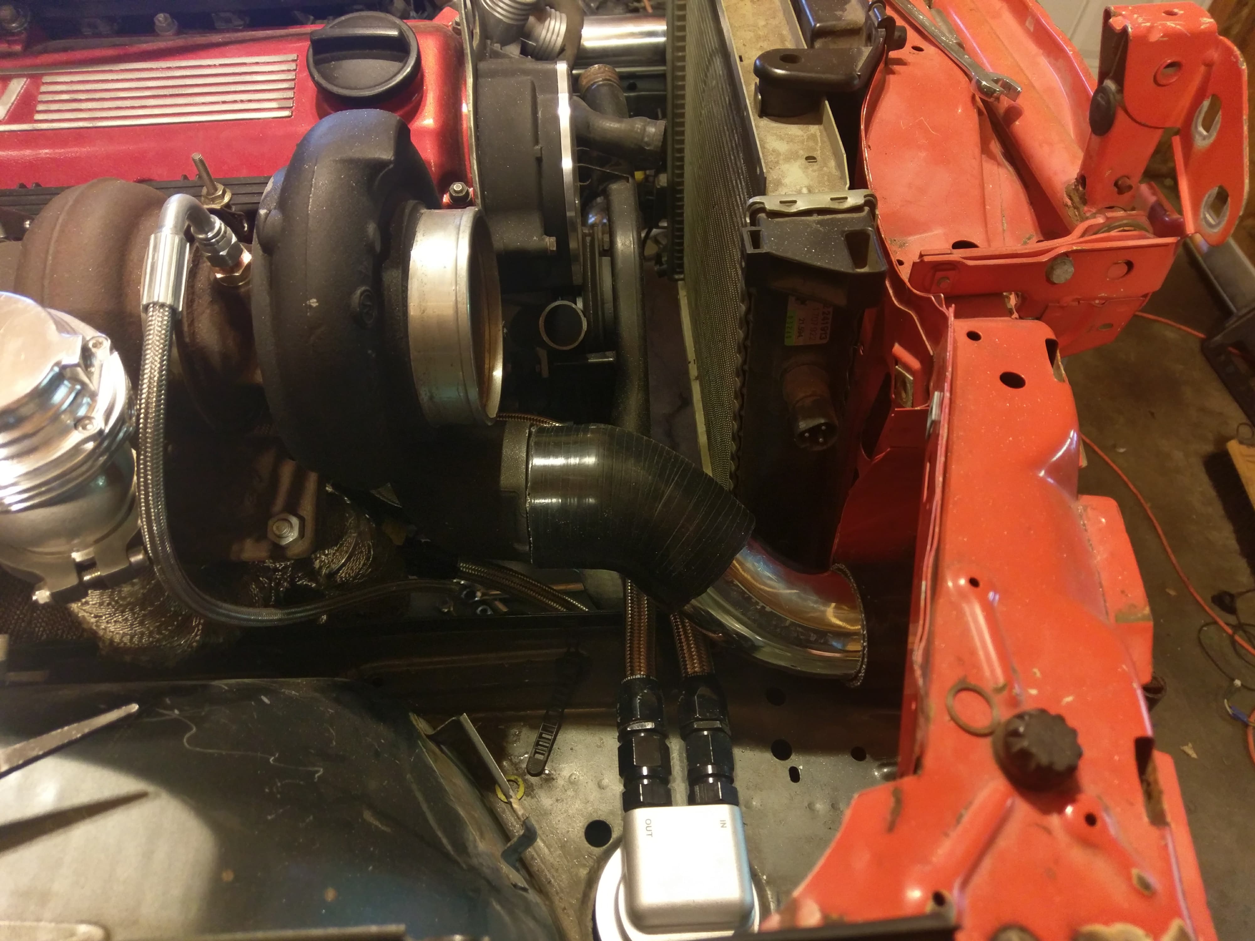

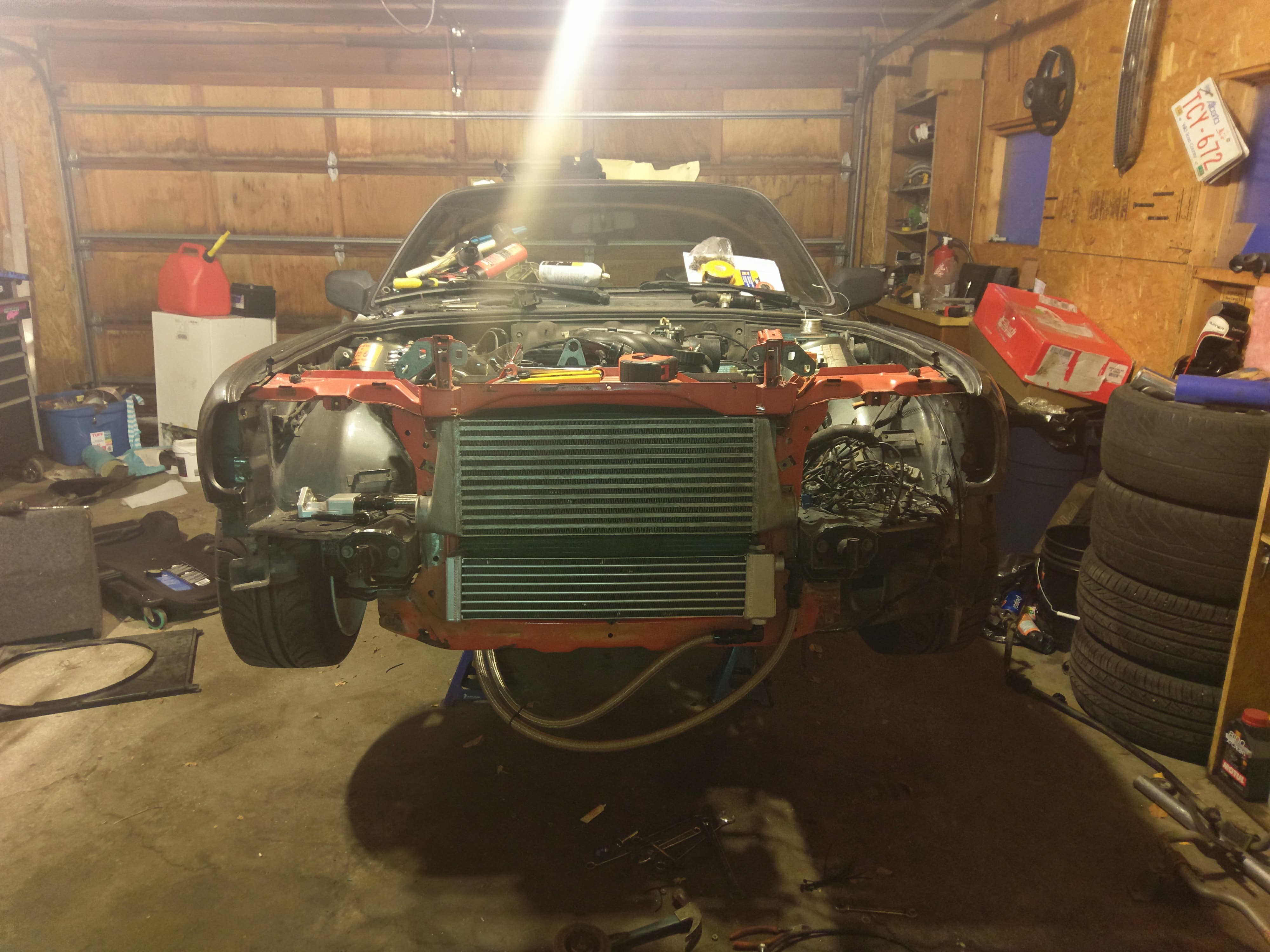

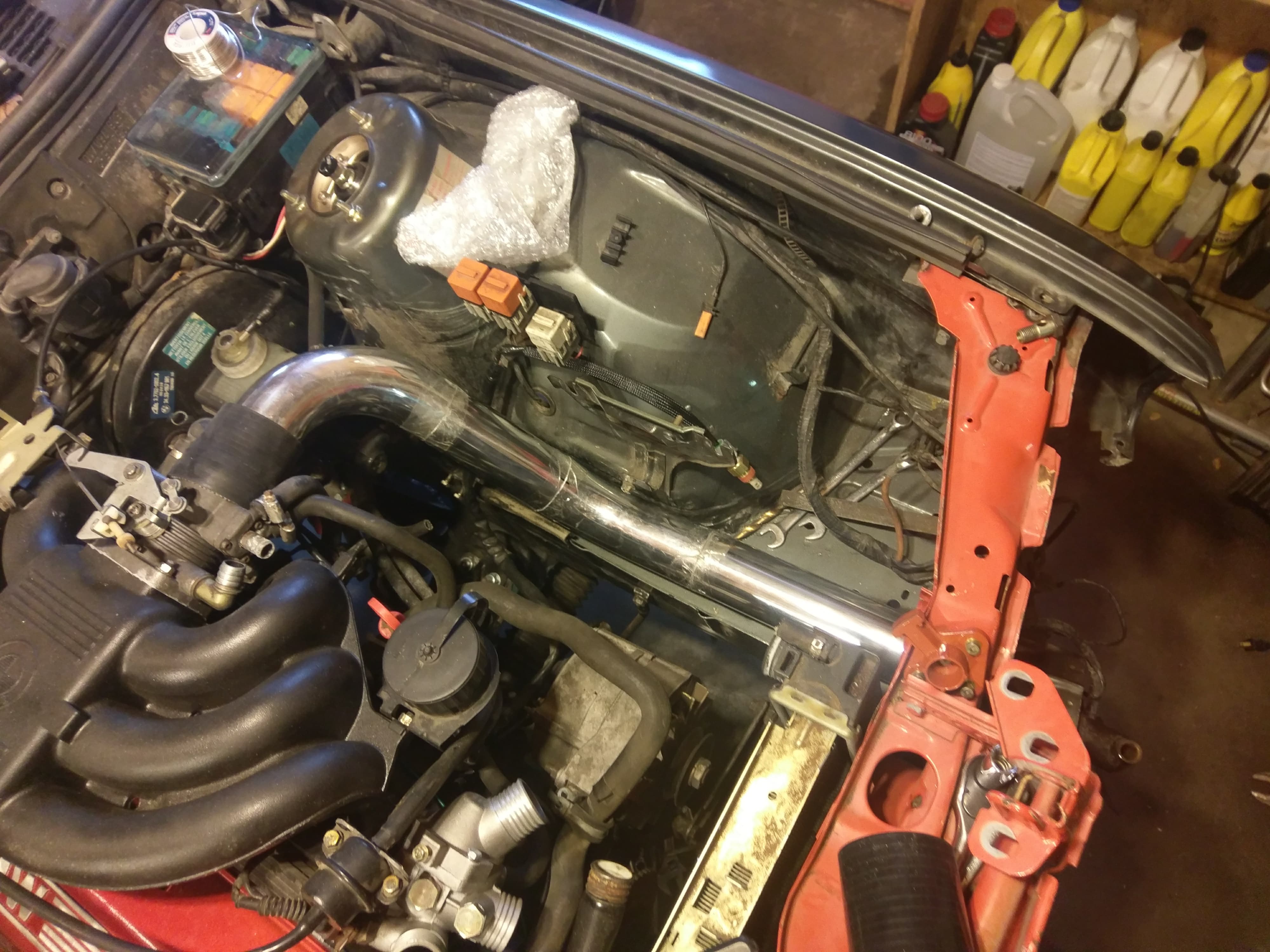

    Had some friends help me fab up some custom intercooler piping and exhaust and added a wastegate to the turbo manifold.
    Figured I might as well keep it sleeperish looking and mount the intercooler behind the grille and keep it low key. I also added an aftermarket oil cooler from an FC RX7 Turbo 2. It fit the lower grille perfectly.
    This is where I lost track of taking photos of the build. I finished up all the suspension and electronics (BCRacing coilovers, new control arms, tie rods, E46 steering rack, Megasquirt PNP, Gauges, Wasted spark) and also some interior touches (2M Shift boot, Recaro SR3 seats from an Evo recovered, Renown Steering wheel, Rally road gauge pods
    Heres a final shot of the engine bay from the turbo M20 setup, I never had it dyno'd but I estimated it to be about 320-350whp on 19 PSI comparatively to the cars it kept up with!
