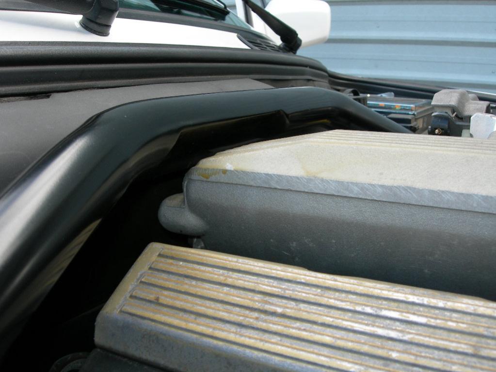

          Here is what I had done to mine at a muffler shop.

            I have my intake manifold sanded way down, and I have the sparco on washers and it still hits at high RPMs. I might need new engine mounts, they look ok though
                I didn't catch that at first, great idea.
                  Im haveing trouble seeing what was done
