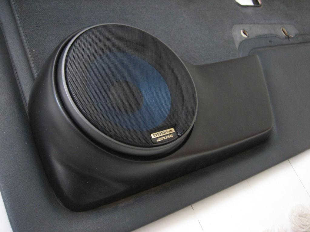

        Are you talking about something like this?
        Fiberglass would work OK, but the issue is the finish.

          Yep something like that. I hate seeing holes cut in door panels when adapting the map pocket is such a cleaner way to go. I hope a mold won't cost 5k because it would take a hell of a lot of sets to make that money back. On to more research then.

                      Production will begin soon......hopefully. I won't be going with injection molding, for now because of cost, however I have a guy who will be helping me with molds and also making some using existing map pockets. The plan is for the part that is not taken up by the speaker to be able to house a crossover and yes a hole will need to be cut in the door still but it won't be seen and will look much cleaner.
