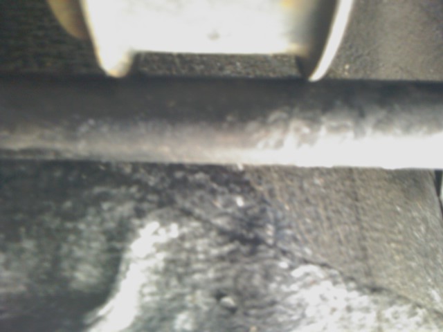

    * Had to "creatively move" about 10 mm deep of metal on the spare tire well with a baby sledge and a piece of steel rod (ie: I put the steel rod against the leading lower edge of the well, and pounded against it with the baby sledge until it was carefully dented inward about 10 mm, then repainted with bedliner just in case...)
    * The left side BARELY clears the exhaust, and the bar BARELY clears the diff mount and (newly refashioned) spare tire well.

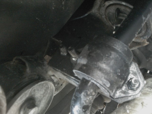

      Ok./.// here we go.. pardon the salt, we had snow last night!
      I made the brackets extra beefy, and coated them about 4 times with bedliner, then drilled a second hole in the original mount,
      and bolted the top of the newly fabbed bracket to the top bolt. Second hole was 11 mm lower - there was a corresponding hole in
      the fabbed bracket AND a hole in the stock M3 "strap". A large washer is in the back side of each hole in the original mount to distribute the
      stress and the second hole goes through a large washer, the new hole in the original mount, the 8mm thick fabbed drop bracket, and then
      the M3 "strap". All hardware is grade 12.9 metric. lock nuts are the metal/metal type (not the plastic insert type) AND have blue locktite
      on them. 150 mile check-up shows everything looking good! very little clearance @ exhaust; I will "touch up" driver side fabbed drop
      bracket with angle grinder to give another 3 mm clearance. 330i brake upgrade w/hawk pads and drilled rotors coming soon! (before
      HPDE and track days come around!)
