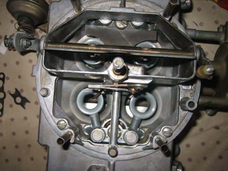

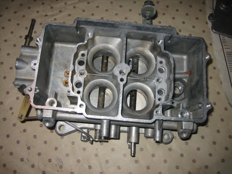

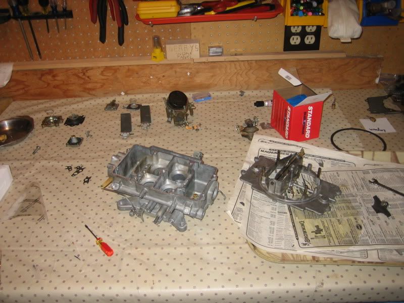

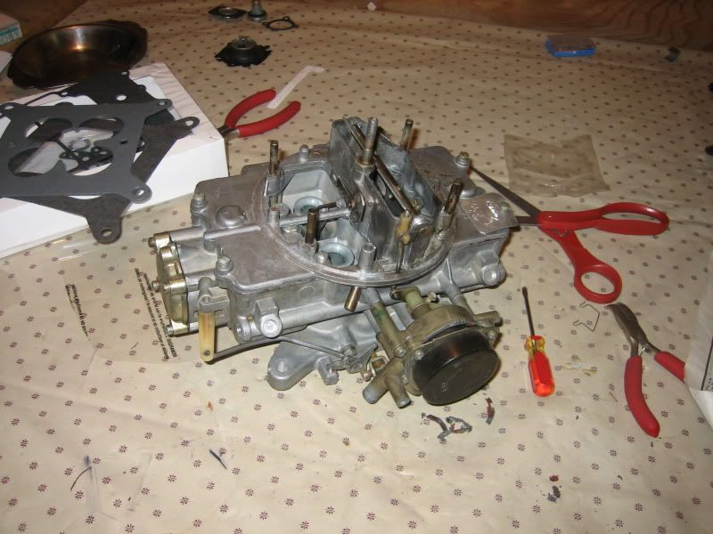

I had some issues getting the correct carb kit, I finally got the right one today. Just got it all rebuilt and put back on the car. It was a quazi-win
It "runs" now, but poorly. No more leaking gas though! The choke isn't set right, since I didn't realize how it came apart I didn't mark it. The dashpot is broken, but I don't know how big of a running issue that is for now. Also upon re-assembly a plastic fitting that threads on a rod for the choke broke preventing the choke plate from opening correctly.
I didn't put the ignition parts in yet, I need to track down a dwell meter to do so. But when it does run, it shakes and sounds like it's running on 3 cyl max...
Not to mention the 2 year old gas in the tank...
Next step is to order more parts to fix the choke on it now. Drain the gas, put fresh stuff in, and see where I can go from there. I'm probably going to wait for my father to come help me out just because he knows a lot more about points and carbs than I do, he will make the work a lot quicker.

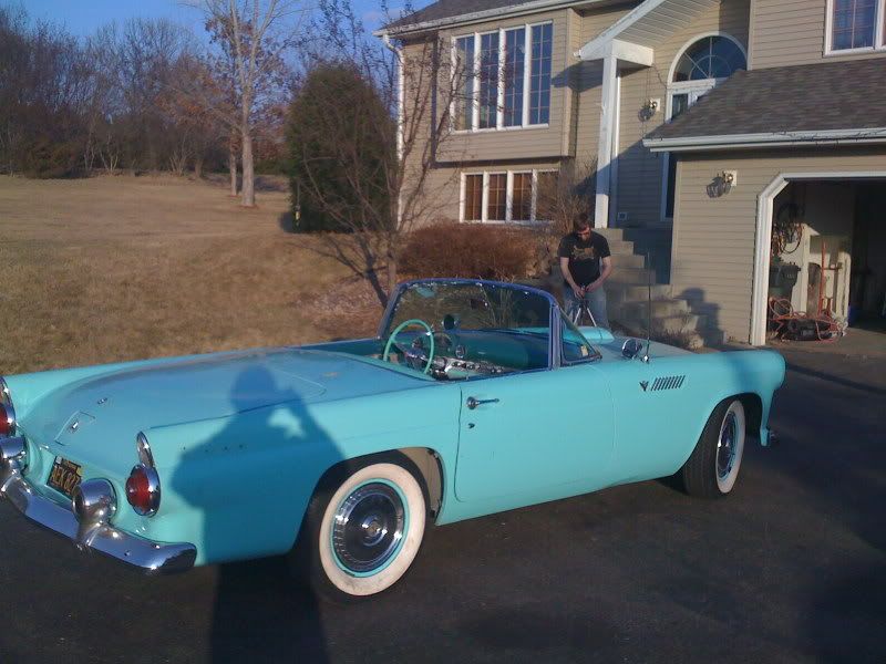

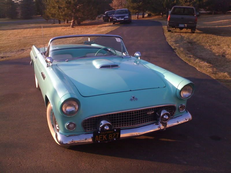

Like 55's? My buddy restored this one last summer, these are before pics:
Car ended up being the biggest nightmare piece of shit I have ever worked on. It looked nice before we dug into it, but that thing was a cobbled piece of shit. There had to be a solid 20 lbs of bondo on the body, and every screw was fucking different. I've never seen so many wood screws holding a car together before.
I have no after pics, fuck that car...Rollin' with a GeistkuchenComment

Turns out I had the choke linkage installed incorrectly, it was binding against the carb body so it wouldn't work. I took the carb out and corrected everything, set the choke, and put it back on. Fired right up and ran smooth, just wouldn't idle. I shut it down and adjusted the choke again to try and richen it up, after that though I can't get it to run anymore...
It still seems that the linkage is binding when I try to adjust it, but when I pull it apart a bit everything moves freely. Does anyone know if there's a special way you have to set hot air chokes? I can set it where it should be, and sometimes adjusting it will move the choke plate, and sometimes it won't move at all....
I didn't touch the mixture adjustments, and it was running just fine before I messed with the choke again, so I'm still thinking I have a choke problem. The only 2 ways I can get it to run is either really poorly like it's goin on 2 cyl and shooting black smoke out the tail pipe, or I have to keep it at WOT to get enough gas to almost make it idle at like 400rpm... I can't seem to get to any middle ground again.Rollin' with a GeistkuchenComment

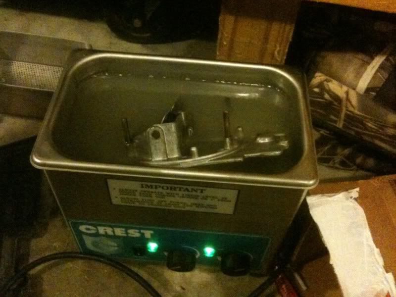

Yeah they work damn good, I didn't use the correct cleaner though which makes a HUGE difference. It probably would have worked awesome if I used carb cleaner, but I use that ultrasonic cleaner for electronics so I didn't want to dump carb cleaner in it. It helped a lot, but it could be a lot better.
That's how it should work.Rollin' with a GeistkuchenComment
FINALLY got it going. 3rd time the charm for tearing the carb down. What happened was I forgot to put the economizer washer/gasket in. Without that in all the fuel from the primary chamber would just leak down into the intake, dumping all the gas in at once.
So I put that in, did all the adjustments, put it back in the car, and she fired up and ran idled smooth.
