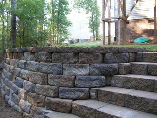

    They call this a rubble wall, what other names are associated with this style concrete walls. I want to retain more of a slope but it needs not to be decorative in anyway.
    Needs strength though.

                  As far as the wall goes not hard to do. I did some stuff like that with the broken face a few years ago, apoured wall with a true footer might be better depending on how much dirt you are trying to hold up.
                  As far as drive way goes. Any time grass is on anything you will kill it by driving on it too much. Never seen it hold up. If you want to reduce heat from pavement, then remove it black top, re claim part of the area with top soil and sod/grass seed and then a traditional limestone gravel drive way/parking area or cement if you want to spend a little money. If you do the limestone put the standard 2a sized drive way stone in, then get a load of "fines" or sand/dust to put on top and wash it in with the hose, will be hard as anything if you do it like that.

                    Need 5 feet in height but will be building on some of the reclaimed land. So need to have a stable base.

                        Also as far as the retaining wall, how many degrees of slope are you looking for?
                        If you did a retaining wall with the offest pattern you would probably be able to create a higher degree of slope.

                            How high of a wall are you going to be supporting with the "retaining wall"? I don't know about Mass. but here you need to have an Engineer to sign off over some height, I want to say 10ft, but I'm a probably wrong there. Something to look into. They're very easy to build, compacted 3/4" crush base, flat cement footing, first few block layers filled with cement, locking pins...just make sure you have good drainage.

                              I need approximately 5 feet nothing drastic just stopping soil from sliding down a bank of a former canal. That is all.
