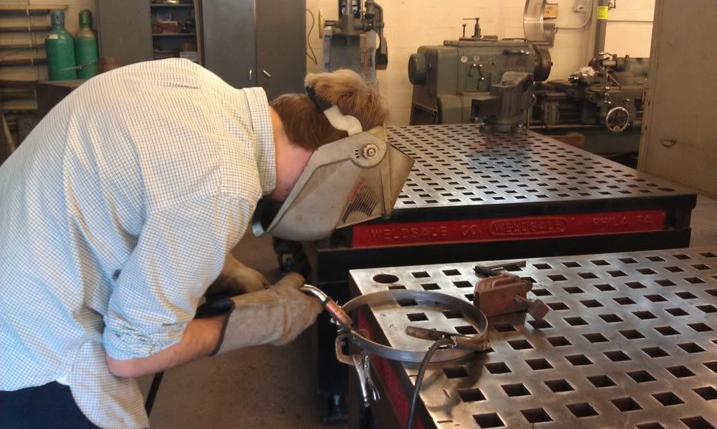

Use the thickest top you can get/ afford, like def affe said 3/4-1" If you are getting if from a shop look into getting slot cuts into so you can clamp things down, similar to a acorn table or similar
Vise mount is also a good idea, something that can be easily removed when its not getting used.
Like James said. These types of tables are awesome. This one had big question marked shaped bars that slid down in the slots and held down whatever you were working on really well. It also had a vise mount. I miss having free rein on these.

I would also try and make it so the plate hangs over the frame a ways, that way you can easily get a clamp under it to clamp stuff down. If you have sides like the tables above, you can use clamps.
