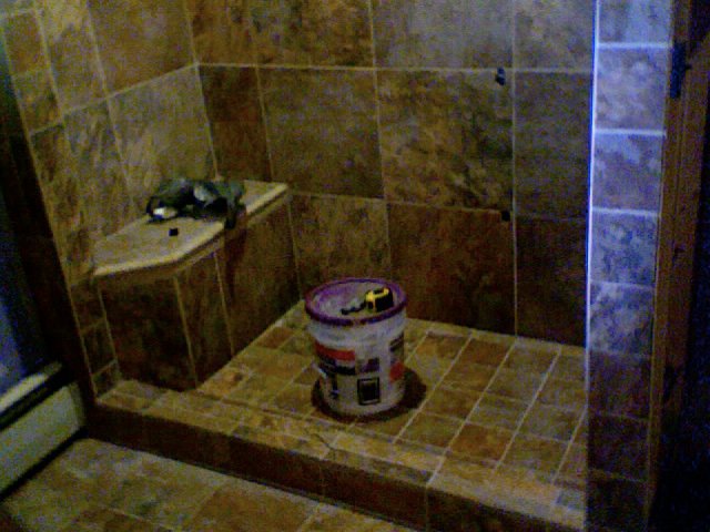

                  one of our bathrooms just got completely renovated. Wall was completely rotten and falling apart more and more daily, ceiling was this retarded spiky sponge paint type deal covered in mold. shit sucked. looks 100000x better now.
