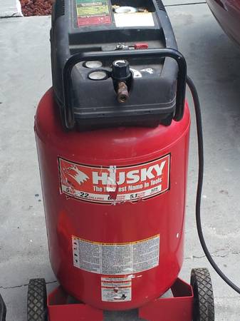

    How does this one look? One thing I read is that you definitely want 220v rather than 120v, does this still apply for what I'm trying to accomplish?

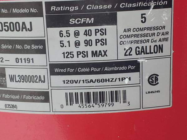

    Specs from pic:
    SCFM
    6.5 @ 40 PSI
    5.1 @ 90 PSI
    125 PSI MAX
    5HP - 22 Gallon - 120V

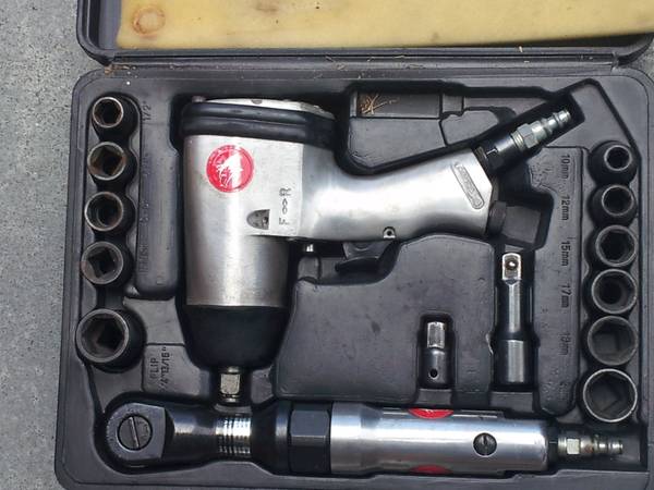

    "husky 5hp.compressor hoses and impact wrench, air ratchet, sockets 125 o.b.o."

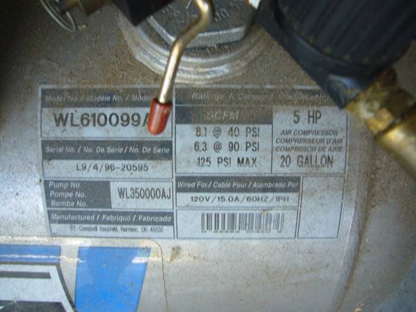

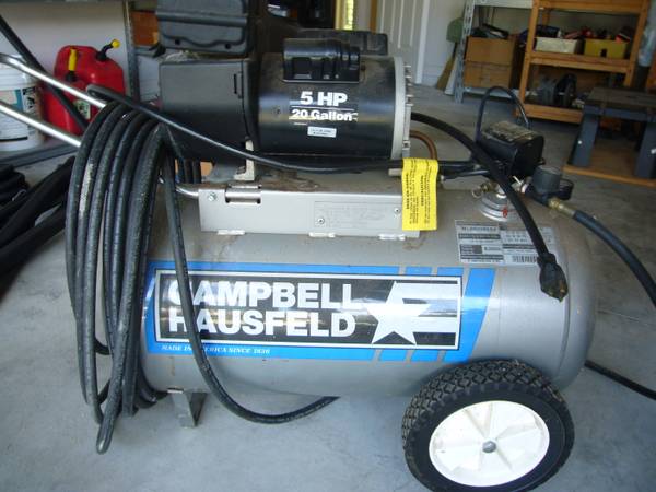

                          How bout this one? Still 120v but a little bit better rated CFM numbers though no belt (oil less)?
