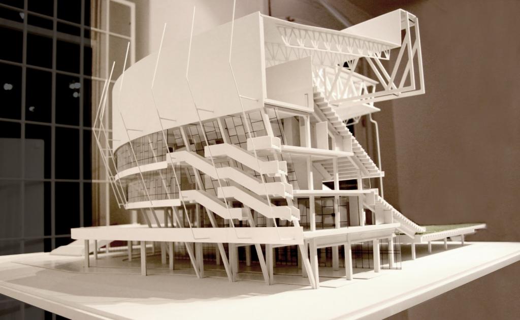

        Neat stuff. Is it impervious?
        Maybe what I've seen lately was the new generation of cheap desktop printers - the output looked pretty rough.
        You see things like this though - amazing...
