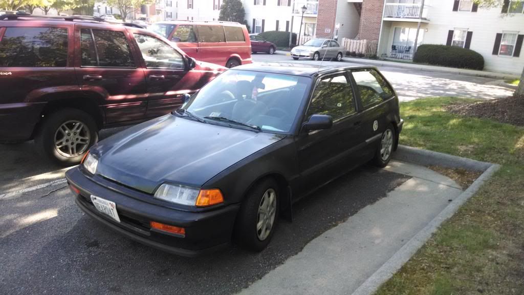

    Meet Spike, my 1991 Civic SI Hatch. You may have seen him in the "Recent purchase" and "Weekend" threads, but I am having so much fun with this car in my 3 days of ownership that I feel he deserves his own thread.
    He is a rust free EF, except for some small surface spots on the quarter panels which will be addressed.
    He also comes with a JDM B20B Engine rated at roughly 150hp, mated to a b16 transmission, with a brand new Exedy clutch. Everything else on this car is stock.
    I purchased spike for $1300 and was told that he needed a starter and a fuel pump.
    Upon purchase, I tested for power at the fuel pump and had good voltage. When I reconnected the fuel pump harness, the fuel pump suddenly worked! Sweet!
    Starter was a no go, so I replaced it.
    Crank, no start. Shit.
    Plugged in a noid light, and saw no injector pulse. Next stop, ECM.
    Pulled up the carpet, found a ECM loosely laying on the floor, with a connector half way unplugged.
    Plugged it in, and Vroom.
    So total invested, $1500. This little car hauls freaking ass for what it is. Spins the tires through first gear, enough to put a smile on my face.
    So this shall be my Off topic Honda members ride thread, and I shall update it often. This weekend should consist of new front end bushings and a good cleaning. Shots of engine bay to follow.
