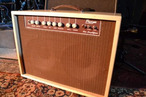

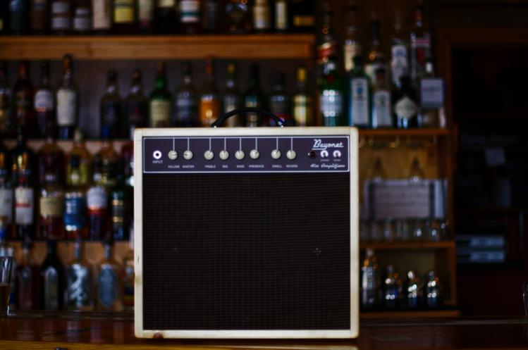

                              Check out 41st Amplifiers. Hand-wired tube git-tar amps built right here in Missoula MT, for way less than pro-level stuff...
                              http://www.41stamplifiers.com
