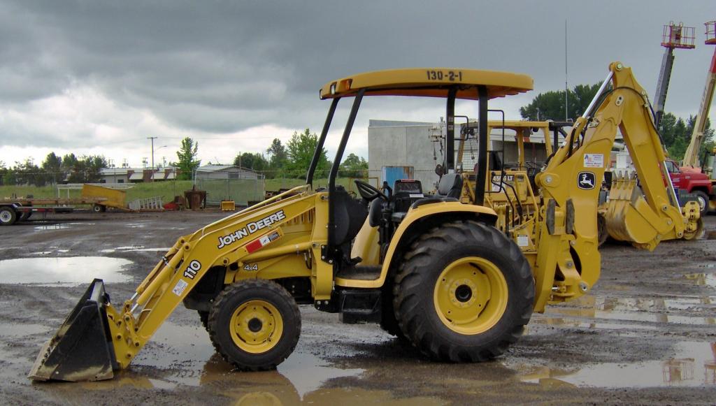

                Slightly off-topic. There is an old John Deere light duty loader/backhoe in the front yard of this house near me. It's been sitting for years. I want to knock on the door, but fear chasing that restoration would be big $$.
                These are the ads that distract me: http://boston.craigslist.org/bmw/grd/5020608900.html $6,000 for a loader/backhoe. I could almost justify the four hours pushing a lawn mower around.
