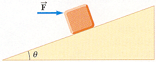

    A 2.00 kg block is held in equilibrium on an incline of angle = 55° by a horizontal force applied parallel to the floor. If the coefficient of static friction between block and incline is µs = 0.300, determine the following.
    (a) the minimum value of
    N
    (b) the normal force exerted by the incline on the block
    N

    A.) "a horizontal force applied parallel to the floor" - surely you mean a VERTICAL force over a frictionless pulley at the end of the ramp. A Drawing would help.
    Compute the normal force - and your have way there..
    Dude - it's 3 or 5 equations for part b...not hard - if you that this is hard - wait till light and mag's...

        #1, find the normal force first, if you have a text, read it and do examples, if you don't, buy a Schaums Outline or hit the bottom of this page http://en.wikipedia.org/wiki/Inclined_plane
        to get you started the normal force is (2kg)*(9.81m/s^2)cos(55deg)
        the accelerating force in the direction of the slope is (2kg)*(9.81m/s^2)sin(55deg). Find the horizontal portion of the accelerating force and friction force and do a force balance....DRAW DIAGRAMS
        Friction Force(horiz) + Applied Force = Accelerating Force(horiz)
        #2, force balance, put all the forces in one direction on one side, and all the forces in the other direction on the other side, solve...
