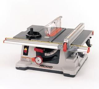

                            You guys may laugh at me, but I sold them when they were made in Paris Tn, and they still rule even after going overseas.
                            This is a contractor saw, but comes with a full size miter guage, indexing 10 inch blade, extendable right side table, and one of the best rip fences for a portable saw on the market. It weighs @ 75lbs, can sit on sawhorses or the back of a truck, and has a dust shoot you can hook a full size wetdry vac up to. It even has an erasable part on the table to mark the kerf of the blade.
                            It is direct drive, and a 3/4 hp motor I believe. That being said it is a Miter saw turned upside down. It's loud but will cut through a peice of 3/4 ply easily. I own one and I own a larger stationary belt driven Ridgid. Also A radial arm. The little guy is by far my fave. And it is cheap. With a lifetime warranty I believe.
