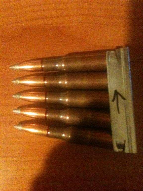

      I have a problem with my Mosin. When I go to cycle it, sometimes the next round (but usually the first round) won't slide up into the chamber. It just chills down there like "fuck you!" and jams up. I free it up by opening the bottom of the magazine, and generally that causes it to shift into a position that favors it sliding into the chamber.
      I've tried taking it apart, oiling everything up, etc, etc. No dice.
      Any thoughts?
      If the top round wont strip off, most likely your mag spring sucks and there not much you can do about it. and or
      you are rim locking. to not do this make sure the each consecutive round you insert into the magazine, the rim is INFRONT of the one below it.There is an interrupter built into the rifle to do this, but it dosent always work.
      Rounds in your magazine should be inserted like this.
      If loading with stripper clips, you bottom round should be angled up, like this, other wise it is upside down and is guarenteeed to rim lock.

        ^^This must be the problem. I'd just been dropping them in one at a time. Stripper clips got lost, etc. I need to get some more and arrange the cartridges I guess.
        Thanks! :up:
