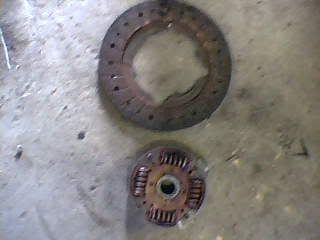

    I had to pull my transmission out of my truck, look at what I found.
    Well, I thought the transmission in my truck had bit the bullet back on Tuesday. I have been dreading having to take the transmission out, take it and the spare transmission I have over to our rebuild guy and have him rebuild it. Well, I definitely don't have to have it rebuilt. I just have to put ANOTHER clutch in it. I didn't even have 700 miles on this damn thing and it kurploded on me.
    I didn't think my little 1984 Nissan carb'd 8-valve,8-spark plugged, 4-cylinder would do that kind of damage to a brand new clutch. Oh well, I'm going to have it defected through WorlPac through my work and have them send me a non-sport clutch. The straps that hold the clutch disc to the sprung hub actually SHEARED apart. The rivets that hold the straps are fine, no distortion, nothing. I have honestly never seen something like this before. Oh, and it's an Exedy clutch.

    That's bizarre. Was it installed correctly? I can't imagine how a clutch would fail like that in normal use.

          same exact thing happened on my stock clutch shifting over 6k rpm on a 2.93 diff. murdered it. it held together long enough to make it home. then i decided since im replacing the clutch might as well rebuild the whole engine :)

              i remember the splines on my pressure plate on the POS mazda i had all broke off, i babied the thing and always kept it under 4000 RPM O_O

                    Yea, Exedy is a real brand. They supply OEM stuff for Nissan, maybe other makes but I'm not sure. When I put it in there I replaced the rear main, pilot bushing (copper bushing and not a bearing), TO bearing, input shaft seal, output shaft seal, etc.
