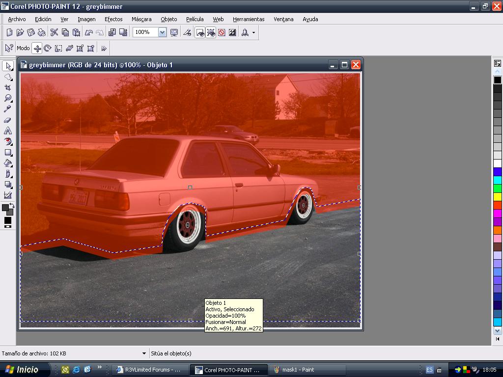

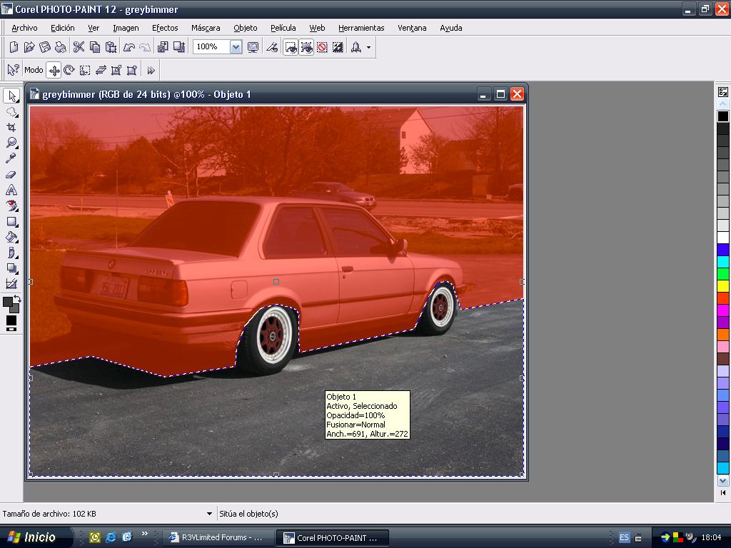

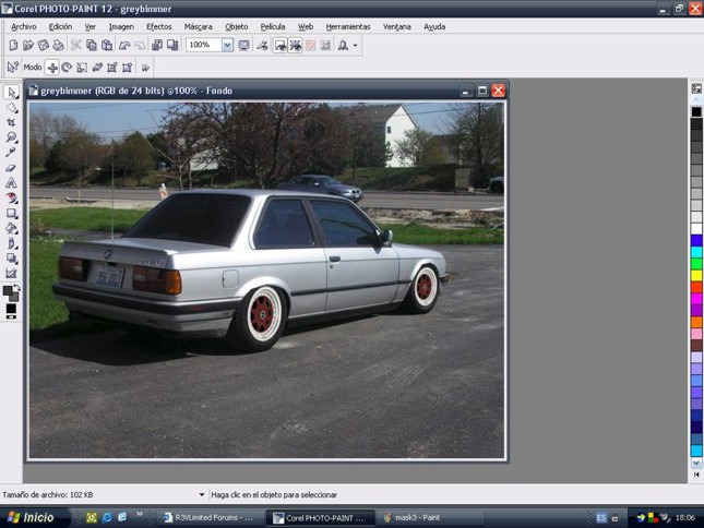

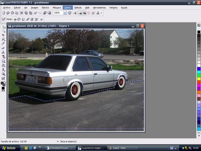

What i do is cut the bottom part and part of the wheels and then move it upwards. I'm attaching 4 images so you can see the process.
I use photo paint though, but in photoshop you would do this in different layers
Then i use the blur or the clone tool to correct problems in the fendersComment
