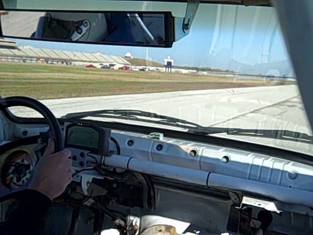

            there is a video from the track... it was a last minute insertion so it's not relaly the best angle.. but you can see and hear the car go :) dont mind the stock steering wheel, i already replaced it.
            brakes are OEM rotors with hawk blue's front and DS3000's rear. stainless lines and rebuilt calipers of course... 735i? master cyl, and a E21 brake booster... They dont have a lot of feel, but stop the car well...
