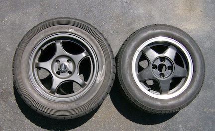

                                Forgot to post this before, but here's the difference betwixt 'regular E30 tire' and 'gravel E30 rally tire'...
