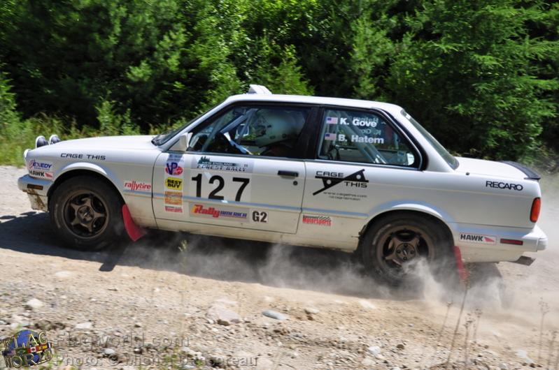

                I just 'finished' my first stage rally, the New England Forest Rally.
                Iamcreepingdeath is right on the money.
                Essentially, except for the cage, skid plate and bash bar (and other required Rally American safety bits), my car is close to stock. I have IE motor mounts and used Bilstein HD shocks/struts with stock -- original -- springs. Brakes, stock (used for three years, including five autocrosses). Engine, stock. Diff, LSD, stock. Even ran the stock exhaust.
                Technically I finished my first rally, which was Day 1 regional, but I cracked my oil pan on Day 2, the second regional (NEFR is the national and Mexico and Errol are the regionals, but run concurrently).
                You can do stock everything, just protect that oil pan!!! Although Maine is known as the "car breaker".
                Good luck and have fun!
                www.slapdashracing.com
                • SlapDash
                  • Jan 2009
                  • 675

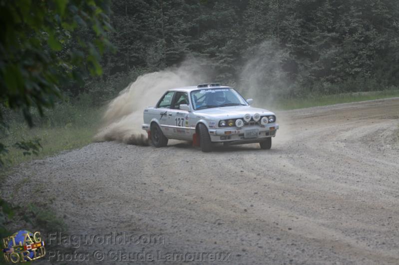

                  Here's another shot...
                      Looks good. What mudflaps are those?
                      • slaterd
                        • Jul 2011
                        • 1731
                        Did you buy a kit to mount those lights on the front or did.you fabricate a mount?

                            If it's rallycross, you could go with just all-seasons, but a lot of people use snow tires for rallycross. Although at Maine, I saw a few with snow tires too, as opposed to full-on rally tires (on a Geo Metro with a motorcycle engine). Ironically, when I autocrossed my car on pavement, I used 10-year-old snow tires. It makes things more difficult, but it helps in the end.
                            The rally tires I have are also very old and worn, but thought they would be better than new snows (plus, I got them for $20/each...that helped).
                            Thanks, I made the mud flaps out of some material my sponsor had laying around in his basement and just self-tapped them into the wheel wells.
                            My cage guy (Bill Doyle, of cagethis.com, shameless plug) made the light bar. It's pretty sick. It's aluminum and he welded tabs to the bumper. I can remove the bar, but I was testing it's mettle, so to speak, so I could make sure it stayed on that night (it did).
                            Despite the skid plate and the bash bar, which was/is like a roll cage built around the oil pan underneath the skid plate, we still cracked the pan. I was trying to avoid giant rocks and ended up hitting one unseen one (finished the stage though).
                            And what jasonsnoddy said. I got brand-new -- but stock -- control arms and swapped a newer steering rack.
