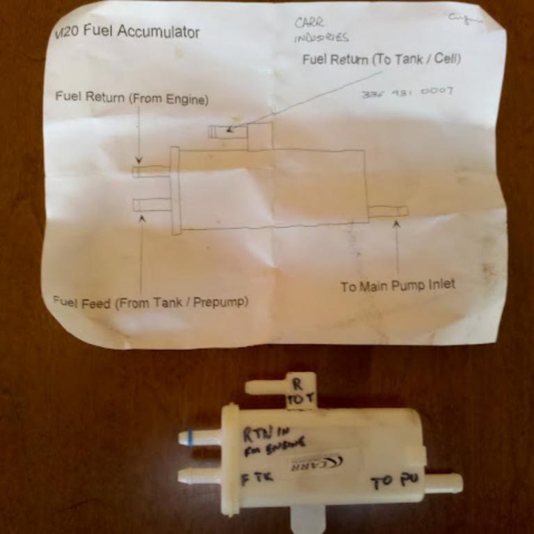

        Thanks! Ordered! Does anyone have a pic of one of these installed? Will I need to be splicing/adding new fuel line - or does it just slip into place?
          Got it, already packed will go out tomorrow am. On the link there is a picture which shows how the lines get hooked up.

              Very nice product, but be sure to check the welds. We had an issue with one that was mounted and spewed fuel like nobodies business.
              Could have been from install, or something else. Cover three holes and blow in the fourth, that should tell you what you need to know.

                how much fuel can this hold ?

                  I would guess around 8oz they are a lot smaller then they look in pictures. For a street car that you take on the track once in a while I would use this as you can mount it hidden under the car but for a race car I would get something bigger that is not plastic.

                        Anyone have a picture of how they held this in place?

                          i would like to see that also .. I see the drawing but where do you install this..Thanks

                            Ill see if I can get a pick of mine. I modified the bracket that holds the fuel pump and filter. It tucks nice up on the tank lip.

                                Someone post up some pics. Its a bit of a cluttered mess in that area. I'd like to see what people are doing.
