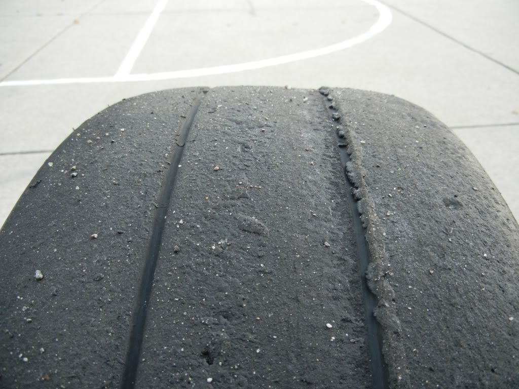

    Noticed this when changing the tires back, have no idea why/how this happened. The rear tires developed these ridges on the outside edge, anybody have any idea why?

          Anybody have any insight on my tire issue?

            I'm not 100% but I'd guess the 225's crammed onto skinny wheels are probably under inflated and the sidewall is buckling under load.This could cause the tread surface to deform resulting in high/low spots that are worn accordlingly as the tire hits the track.
            I've run 195 r-comps on a 6" wheel and they are even a little pinched,I wouldn't go any bigger than a 205 on the snowflakes.
