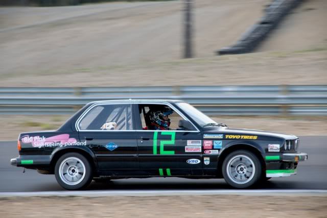

                  We ran our e30 chump car this weekend at The Ridge and ended up in 6th out of 66 cars registered. The car is bone stock with the exception of Bilstein Shocks. No chip and stock exhaust manifolds. Chump Car can and will check your ECU to see if you have a chip if you place high enough. I believe John and James are running a m30 in their car. The most important thing is to make sure you have a low enough AIV and document it well for tech inspection. The only time we ran into the engine running hot was during red flag situations but you can run an auxiliary electric fan to keep it cool.

                      • ballarde30
                        • 369
                        No, we were in the black e30, #12. No contact all weekend.
