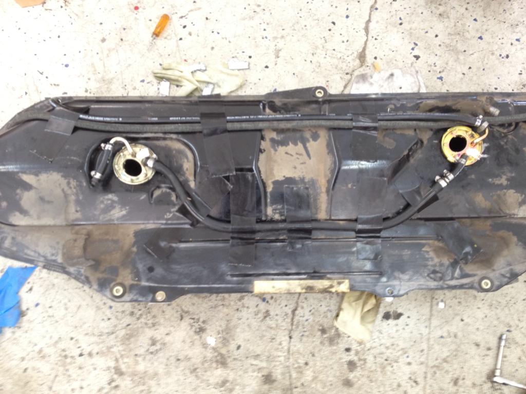

      Originally posted by porschelou
      Lot's of good inputs above. Just wanted to relay what we did with our 86 325e ( sporting a 3.5L ). We race Chumps and Lemons and needed to try and reach the 2hr mark.
      1. Pulled the factory 55L tank
      2. Bought a good used 65L tanks
      3. Installed a 318i low pressure pump (plugged the return tube) on the left side ( you will need to use a file and shorten one of the tabs on the tank so the locking ring locks in)
      4. Installed a new 325i high pressure intank pump on the right side
      5. Ran the output of the low pressure side to the return side of the high pressure pump ( this will keep pushing any fuel from the left side to the right). I just used fuel line and ran it across the top of the tank. I think there were a few spots (on the body) I had to hit with a hammer to make sure this hose wasn't pinched at all.
      6. Connected the high pressure pump output to the line running to the fuel rail ( had to use a brass reducer I got from ACE hardware to match the fuel line sizes).
      7. The return line from the fuel rail gets connected to the siphon line on the tank ( I'm guessing this helps push fuel to the right side as well).
      8. Removed the high pressure pump from the frame rail
      9. Extended the factory high pressure pump wiring and supplied power to both pumps.
      10. The 325e only had one fuel pump cover under the back seat so I added another one above the low pressure pump so I could work on it. Went to the junk yard and got a cover from a 325i. Once I got it on it looks factory ( as long as the inspectors don't figure our this was a "e" car).
      11. Replaced the filter
      We have a done a 24hr race a VIR last year after I completed the conversion. Ran well - we got about 1hr 45min out of it before we got nervous and brought it in for fill up. Never starved. We just found out that the WOT on the TPS was bad so the car was never running on our WOT tune so our fuel mileage would have been worse because of that. Doing Watkins Glen in April - we will give it a new test then :)

      Fantastic! This is exactly what we're hoping to do on our '87 325e/m30 Chump/LeMons racer. We can do 1hr45min with the current 55L tank so a 63L should get us to the magic 2-hour mark just fine.

        Thanks for questioning the fuel pumps NigelStu - It has been a while since I did this..
        You are correct - Since our car was an "e" we had two pumps - low pressure in the stock tank and high pressure on the frame rail.
        Since our low pressure was new I put that on the left side of the new 65L tank.
        I then bought a new 318i pump which is a high pressure pump and has a return nipple on top. The reason you must use the 318 is because the 325 pump only has the high pressure nipple not both the HP and Return.
        Sorry for the confusion. I updated my write-up correcting the original mistakes.
        The 65L tank has a nipple on the left side where your Fuel Rail returns connects to - easy. Once you get the new tank and 318 pump just lay everything out and it's not a real bid deal. Luckily the new tank bolts right in.. Feel free to email me if you have questions.

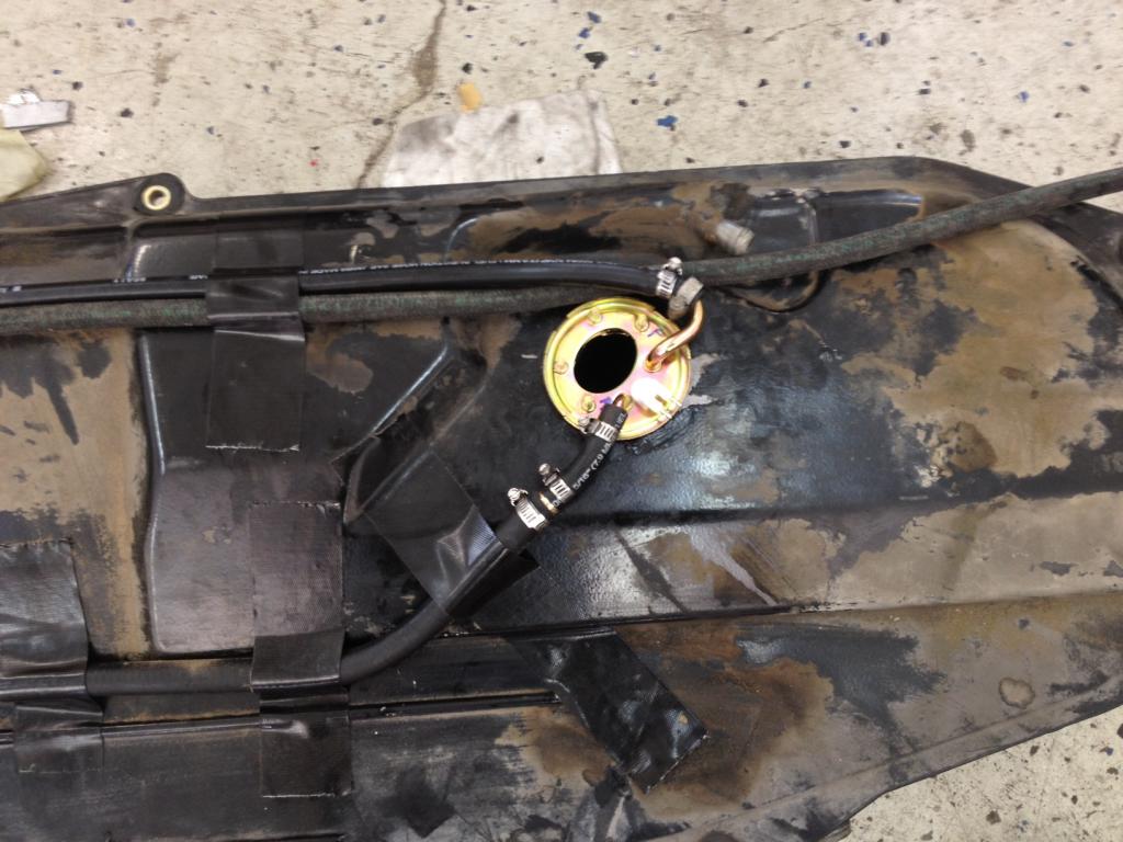

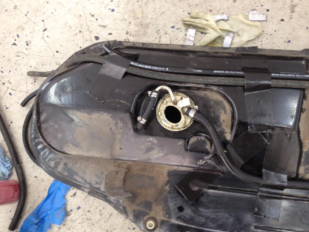

          ^ can ya post up some bigger pics?
          • porschelou
            • 135
            Larger Pic's
            The cloth looking hose is one of the vent lines. You just unplug it when you lower the old tank and move the hose over when re-installing the 65L.
