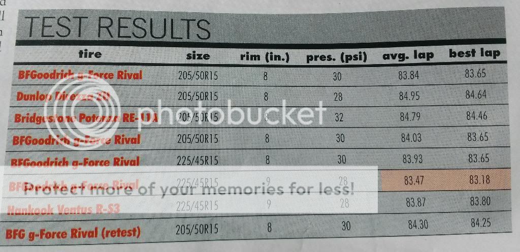

                  Has anyone ever compared lap times using 225-45-15s vs. 205-50-15s of the same tire?
                  Latest grm tire test at harris hill
                  • GillesBigCowboy
                    • 507
                    Nice data, Tinkerputzer.
                    The pressures seem a little low.., Did they do one timed lap at a time, or did they do multi-lap runs?
                    Internet hearsay is that the ZIIs handle the heat and long runs very well.
                    And look at that! On the 8 inch rims, Rivals were faster in 205 than 225, but then on the retest 205 are slower...?
                    The rim width seems to matter, but my 7in. are paid for...
