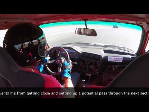

            One of the things that's really necessary in our cars is stabilizing the seat. Even with a fairly stiff seat, it will probably need the back of it braced against the rollbar.
            Here's an in-car video of my car at buttonwillow, no harness or seat bracing. Take a look at how much the seat moves. I'm sure my weight (210 lbs) has nothing to do with that... :roll eyes:
            If you want to read the write up that goes with it - that's here.
