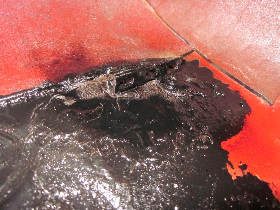

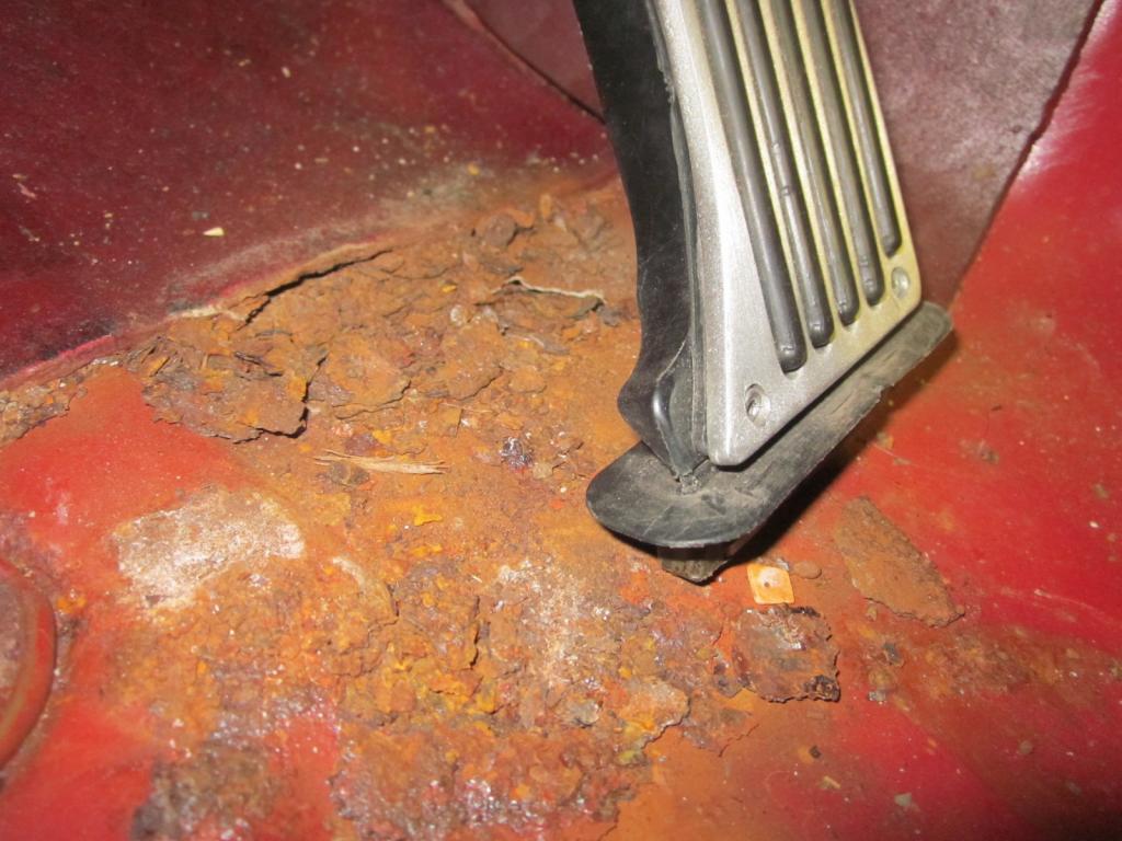

    I'm doing a full interior swap and when I pulled my carpet I found the bracket for the accelerator pedal had rusted from the floorpan. I've treated with rust preventer, then used POR 15, followed by fiberglass. Now my problem is I need to JB Weld the bracket back in place and need to know exact placement sso it will fit thru slot in my new carpet.
    Can you help a guy out? I figure if you could measure from the pedal stop bolt to bracket for the north-south and from the left panel wall to bracket for east-west. Or whatever you find easy that's accurate. Your help is greatly appreciated!
    Here's what I found under the carpet...

    Have someone cut that mess out and reweld a tab in for the pedal. I would not want that gas pedal to break off on track or worse... get stuck down.

      I should clarify-this is not a track car, just need measurements w/o carpet for an accurate placement. I appreciate your consideration for my safety, but I'm confident that JB Weld will be fine in this application. It's approved for bonding to fiberglass and if the bracket didn't come loose with the floor being that rusted, it won't come loose now.

            I got measurements from a parts car sans carpet at my buddy Ben's shop yesterday, and before I did the JB Weld process and attached it to the floor I drilled a hole in each of the mounting tabs so I could screw it down as added insurance. I also ordered a new accelerator pedal cause the plastic tabs on mine weren't in the greatest condition.
            That bitch ain't goin anywhere now...
