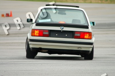

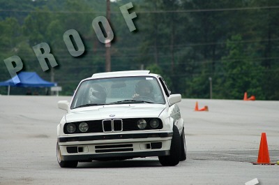

            Dunno if it's me you're referring to but shock and spring combos are somewhat of a personal choice. It also depends on your driving style etc after a certain point. Some don't push their cars hard - others brake late - some left foot brake - others over-do everything....
            Some people assume they can daily these rates. Many variables come to play and I don't claim to be the guru of suspension set up. I think Alex S even runs 500/500 or so depending on the surface he's on.
            I went through about 3 different rates before settling with 600/650 and then did the swaybar delete and liked it. You cannot totally eliminate body roll on a car that you will drive on the street. You might think your set up is roll-free till you see pics of your car being driven hard or see someone else driving your car.
            Personal prefence :D
            Here's pics of 600/650 under different turning conditions with 205-50-15 Falken tires in a 318iS. If you're interested I'll send you the other pics of my car from the HPDE when I get the CD in. Send me a PM

              OT, that last shot is super cool.
