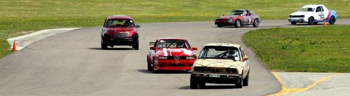

    Our car: http://www.murileemartin.com/UG/LMIS...-_MG_7580.html
    Prep: took rolling parts car off a kid's yard and stripped it, made it run again with the most basic of maintenance of things (spark plugs, air filter, timing belt, etc.), replaced the rotors and went with PFC08 pads and got wheels/tires from Tirerack, roller painted it, then sat out half the first race since rust in the fuel tank was clogging the injectors. So wash your tank out before your first race... We also before the second race hacked the strut towers for more negative camber so it helped to avoid eating tires.
    Other than that... stock 153k eta. Evil Genius said last race that we have the least cheaty E30 and we also have one of the slowest Class A cars so far.
