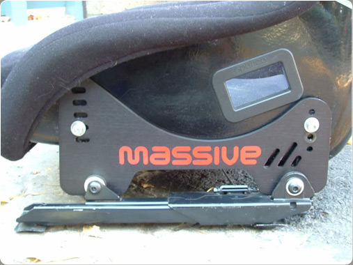

    I have a older sparco Evo 3 and use massivebrakes brackets for the oem sliders. It does have a spacer and a couple washers. Best thing you could do is get the oem slider and one of the side brackets and mock it up your probably going to need some sort of spacer in the front. Alas I'm 6'4 and 160lbs so I can't vouch for the weight. But they seem very study. Also do you even know what brand brackets they are.
    Reference pic from massivebrakes, you can see the spacer in the front
