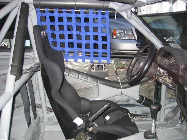

    I had a similar bolt in cage in my track car when I bought it. I cut it out the next day. Fitment was terrible as it is designed to go over a stock interior. This puts the bars VERY close to the driver. Also, that door bar is virtually useless.
    I'd either gut the interior and put in a proper cage, or just use a bolt in roll bar and keep the interior.

      Here is a shot of mine.

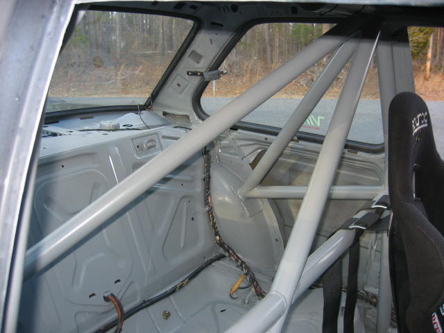

          155///MPH, nice setup, do you have any more pictures of the rear portion of the cage?

            How's this?

              Perfect, thanks...is there any specific reason (rulebook, time/cost) you attached the rear 'stays' to the front of the rear wheelarch? How difficult was it to weld near the B-pillars (did you tilt/drop the cage to weld those?)?
              I'm slowly working my way towards welding in a rollbar for one of my e30's and trying to wrap my head around the process.

                    You can actually weld the entire rear section as one piece and then install it into the car.
                    As far as the rear kick-backs are concerned, there are a number of different options. From a rigidity standpoint, going through the rear bulkhead to the upper spring perches is the best location. We wanted to keep it simple (read: cheaper) and went to the wheel wells instead. The rear bulkhead on these cars is not nearly as solid a piece as it is on the E36/46 cars.
