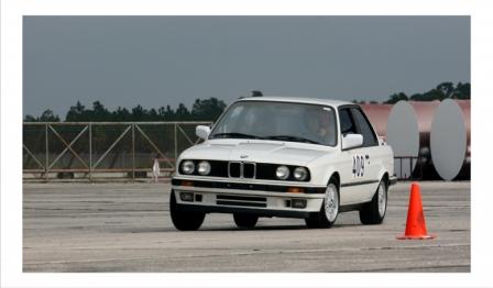

    Well I just attended my first auto x with my new to me 318iS. What a blast,, very addictive. While I had a great time it was very appearent to me that in bone stock form my car is a little sloppy, as I am sure so is my driving. Already signed up for evo school to help solvethe latter prob. Anyway I was just seeking some advice from you guys on where to improve the cars handiling frist? It is my daily driver,,, but I dont mind a harsh ride,, I am almost always the only person in the car. If you guys have any advice on good wheel tire combos and coilover setups I am all ears.. Not worried about going into a different class as right now am just looking to have some good fun. Any advice is appreciated.
    Tire pressure was adjusted after the run in the pic:D
