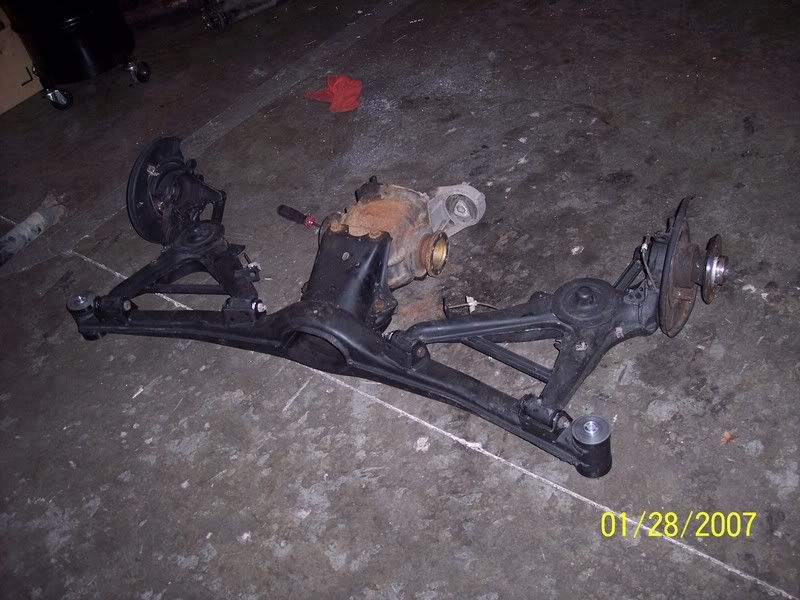

    Well, weight removal is obviously raising the car. When raising the car, camber will go towards positive, both front and rear. Front toe will stay the same, while I believe (somebody please correct me if I'm wrong) with no rear adjustment, rear toe will go out slightly. I can't picture a change in front caster though.
    Here's a picture of my subframe sitting on the ground to try and visualize the movements.

      silly trailing arm reinforments...
      and yes toe WILL change with suspension travel...

          Dom - I already said rear toe will change with suspension travel ;)
          And those 'silly' trailing arms reinforcements keep my trailing arms from flexing and walking around all over the place unlike most stock trailing arms ;)

            You have to remember that the control arm and the tie rod are parallel. There should be no front toe change with ride height change, or not much.
            The rear end will toe in or out depending on where on the curve you are.
            • kendogg
              • Jul 2006
              • 348
              Ahh, good point. I'll edit my post right now then.
