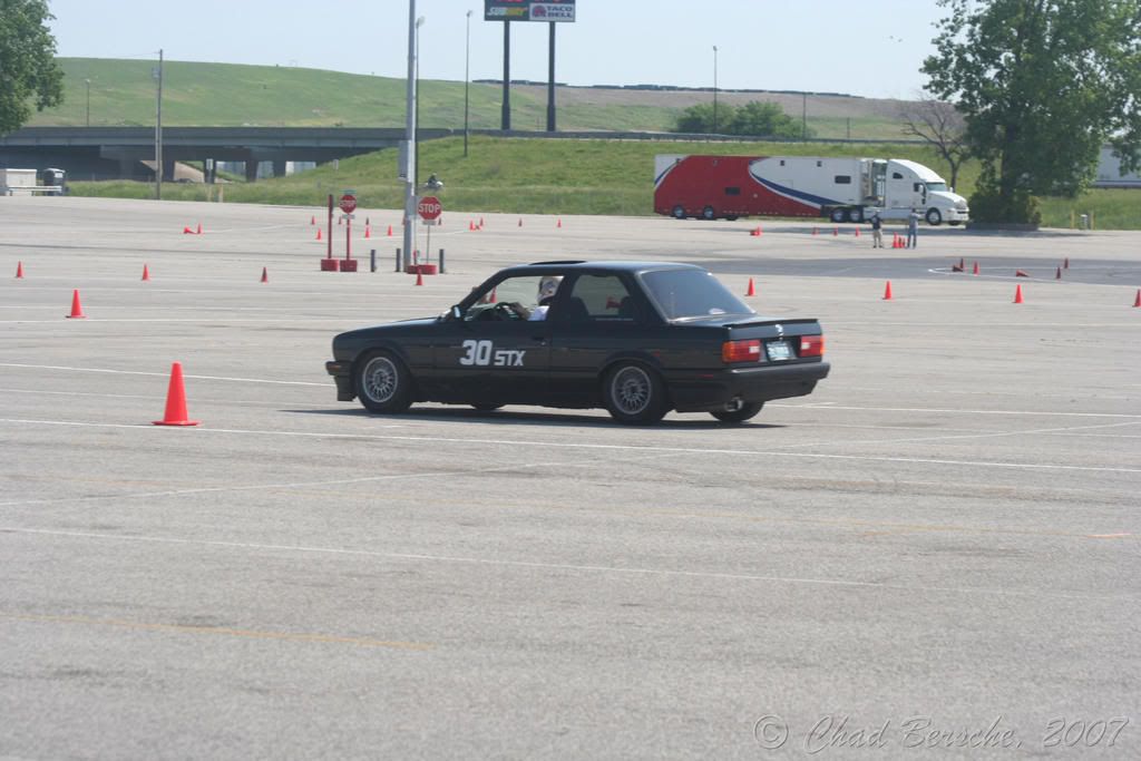

      C3Motorsport Coilovers
      450f/750r Eibach ERS
      Koni SA F&R (Top Adjustable F&R)
      Vorschlag Camber Plates (-3.5)
      Offset Cabs
      Stock Sways
      **Coming Up**
      S50
      IE Big Sways
      500lb Front Springs
      Treeehouse CABS
      Edit: Sorry for the big Pics

        Are THR CAB's STX legal since they change the proportion of metal in the bushing?

          Do yuo have pics of these?
          The C3 Motorsport coil over you bought, came with springs that are Eibach, or did you buy these Eibach springs separatly?
          450 and 750 are the messures for the front and rear, what unit stand for it? load? pressure?
          Someone educate me with suspension techniques and basics, but the stiffer the coil spring, the better for AutoX for example? (besides the bunch of other things that are related to make all this work floswly for each application) Or do you need a specific rate, for example in a e30 for AutoX for the coil spring to make it turn like a go kart?

                    • E30Driv3R
                      • May 2004
                      • 1169
                      You talking about me? if so i have been autoxing for 4 years in the 318 and keep up with the 325s in STX. I have just recently moved to SM since my engine shit out on me...
