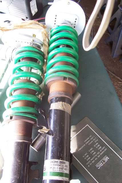

              We are going to have to use an after market bolt on sway bar bracket onto the strut itself.
              The struts we are using are E36 328i Group N struts and they don't have a sway bar attachment point, and I'm incredibly wary of welding onto the tube itself, or am I being overly cautious?
              • mazur
                • Jan 2006
                • 731
                Take the shock out and then weld?
                I am very surprised an aftermarket strut on the E36 didn't come with the endlink tabs in the first place.
                • SA E30
                  • 1248
                  It's a Sachs/ BMW Motorsport E36 Group N Strut.
                  AFAIK, they weren't allowed to relocate the sway bar mount in Group N rules.
                  Can I actually remove the dampener from the strut tube? I was under the impression that you couldn't do this on an e36 strut.
                    Most of e36 aftermarket coilover sets have removable cartridges.

                      I thought bmw motorsport springs had helper springs?
                        If that isn’t a cartridge type design and that shock tube is the OD of the strut, I'm going to assume those motorsport dampers are re-buildable, pull them apart and then weld the sta-bar tabs. If it’s a mono-tube make sure you haven’t locally deformed the ID of the tube at the sta-bar attachment.

                          I just hope that those things were stress tested and brought to failure in both compression and tension.

                                The tops of the strut tube seem to be crimped over. I will snap a picture this afternoon.
