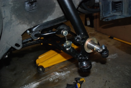

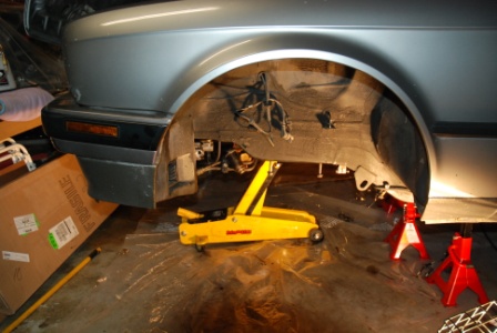

    Pic 1 --Front end stripped out

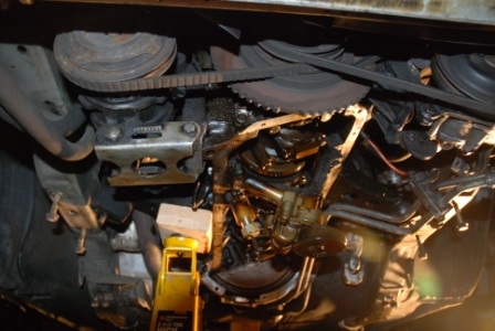

    Pic 2 -- Oil pan, steering rack and subframe out

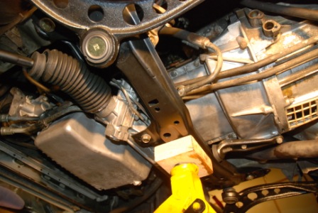

      Pic 3 -- Oil pan and steering rack cleaned and reinstalled with new hoses & gaskets

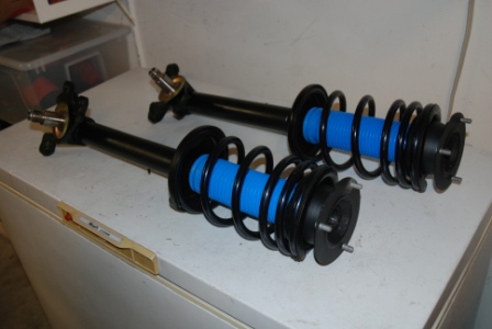

        Pic 4 -- Struts reassembled with H&R springs and Bilstein Sport shocks

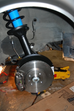

            Pic 6 -- Front suspension back in with new hub/bearing assemblies, new pads & rotors, rebuilt calipers and SS brake lines
