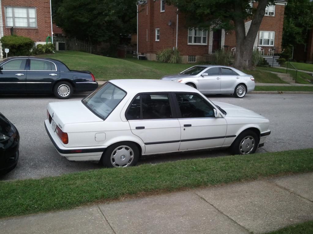

    I was installing a set of Vogtland springs on my e30 and got the back in just fine. then moved to the fronts and couldn't get the locking nut off of the tie rod end. The tie rod end is totally shot and the bolt spins with the nut. I'm planning on just picking some tie rod ends up at autozone and cutting the old ones off, terrible idea? I really want to get these on before Bimmerfest.
