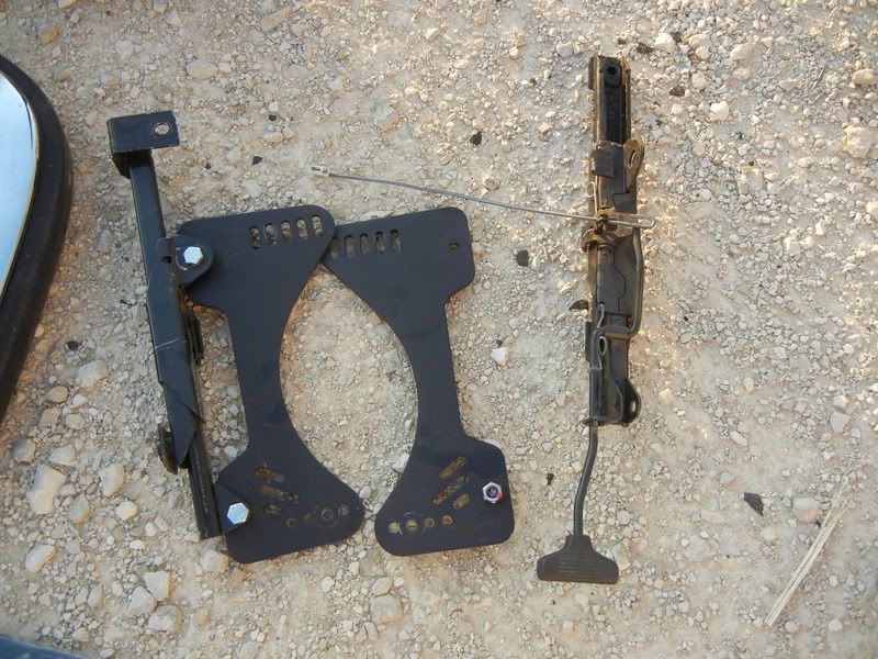

                              little update from me
                              Found this great looking 318 in the basement of the parking garage at work. It sat there for about a week (2 months ago). Haven't seen it since. Temp tags.
                              Also, found this guy at the airport last week
                              As for me, I took the a/c stuff out...so I have parts if they are needed (R12 system).
                              Got some goodies over the last month:
                              I'm thinking I want to mount the seat to some sliders, so I need to look into that. I'd rather not have it on sliders, but the GF races it also, and she is a foot shorter than me.
                              Current car status: Won't start. That's a new development, but I'm working on it. Roland gave some suggestions. We will see how those go.

                                #8355
                                buy my seat mounts!
