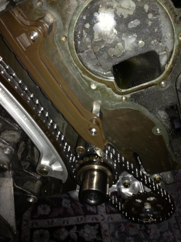

  • tehwickerman
    replied
    Ran into a couple bits where we had to get a bit crafty today but managed to get all the new guides/chained installed without head removal. I'm going to make a write up on how to do it in the near future.
    I don't see how people can say the chains are for life... The chains yea maybe but all of my guides were so brittle it was absurd. The guides should definitely be replaced every 100k IMO.
    Leave a comment:
