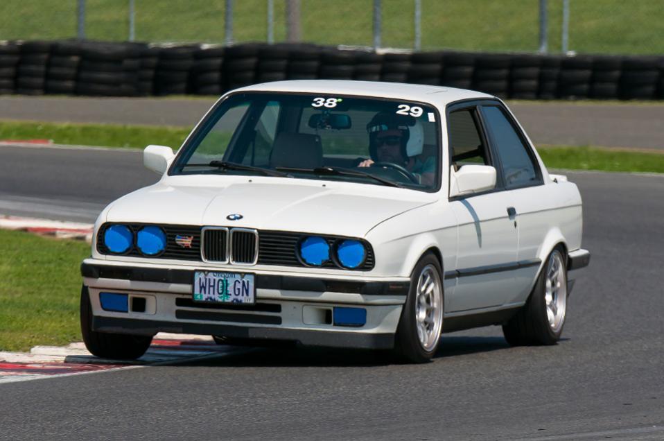

    So, while I don't have anything for sale, I do have purple Vogtlands on my E30 and have been quite happy with them. I think I paid $200 for a full set off ebay. Here's a pic from a track day at PIR. That's the most I've gotten it to squat. That's under full acceleration after series of fast downhill turns.

        I have an S52. I had to roll the rear fenders and am running 15x8 wheels with 225/50 rubber. Looks like you have a little more meat on your car, which could cause issues. What else do you have going suspension-wise?
