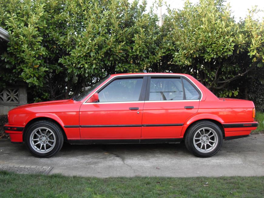

                              Here's my car:
                              No more Borbets but no recent photo's. Keep in mind the tires on the staggered Borbet A's setup were slightly undersized for my taste.
