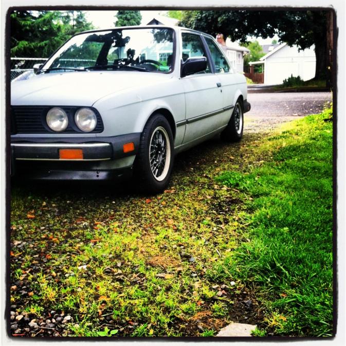

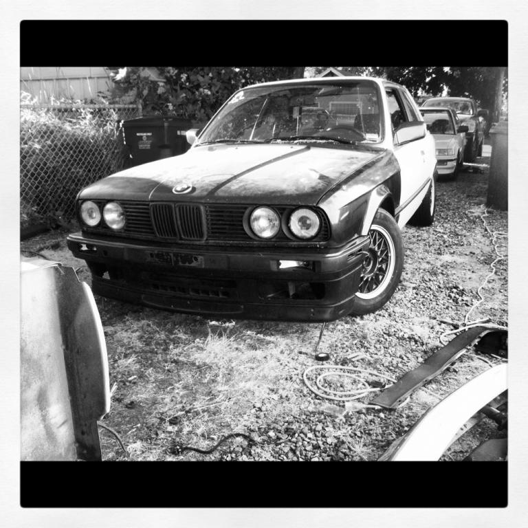

    It sounds like you want to docs facelift conversion I'm halfway through mine the front bolts right on. You just need a late model valance and bumper you also have to cut off your tow hook. The rear is a lot more work. I have not yet done it yet but it involves some metal fab(wich I have no problem doing) but I'm skeptical about the fiberglass. You have to cut a section out of the bumper and Fiberglass the two halves back together. You can always just tuck your bumpers of you have not already done it . Click image for larger version

    The first pic is my car with tucked diving boards(early style bumpers) and the second is the late model bumper conversion with a Volvo lip. The lip will soon be replaced with an is lip once I get my girlfriends e28 running. For now she calls the volvo lip her practice lip lol
    Sorry for the run on sentences, I just took a fatty bong rip.
    Edit just realized that pic is not with the Volvo lip that's just a stock lip that my girlfriend lost.
    The car it's not complete it still has holes where I need fog lights(I put the blinker lense in too
