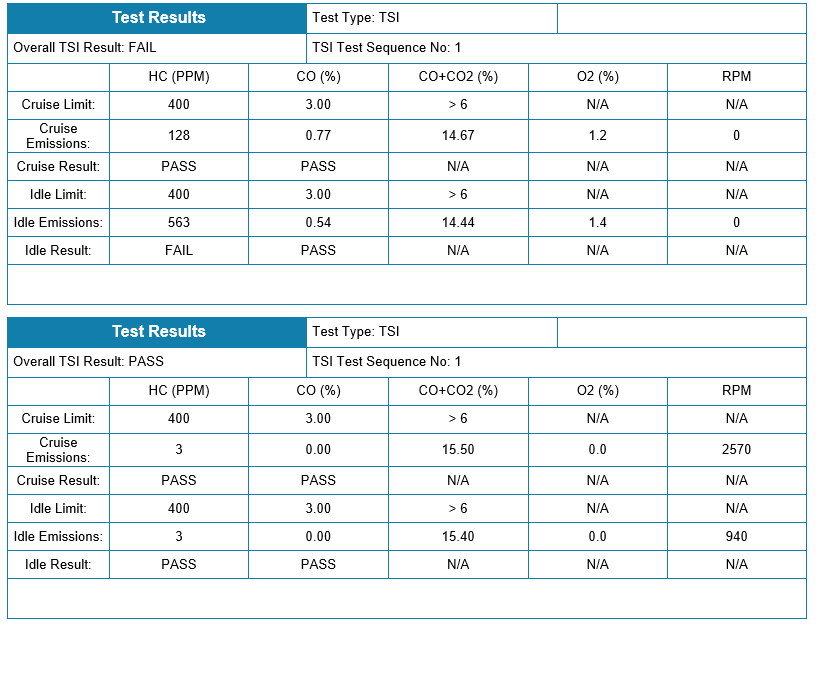

                            Woohoo! Passed, finally!
                            Couldn't find a vacuum leak. Put in a new fuel filter, tried again. No dice. Tabs expired in October. I was driving around for November on expired plates. Just before Thanksgiving I was perusing the classifieds as I seem to do on a twice daily basis, saw an ad for a cat, and decided to try adding in a second cat inline after the first. Cat was $100, installed it for $80 yesterday, went to the emissions testing station this morning. Check out the before & after results!
