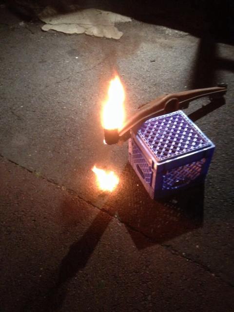

                    Ya need a blow torch
                    And then a hack saw to cut out the metal ring
                    Connect the blade through the center n cut
                    Use a hammer n screw driver once fully cut
                    Don't score the subframe with the saw
                    Press in new bushings and re install

                        Originally posted by vertvertvert
                        [ATTACH]88991[/ATTACH]
                        Heat the subframe instead. Once you melt the rubber on the outside of the bushing's metal ring, it'll slide right out. And with FAR less nauseating black smoke.

                        • 1craze30
                          • 1224
                          Sometimes this works. This is what I did. Didn't exactly come right out. Ended up getting a steel chisel and split it in half.
