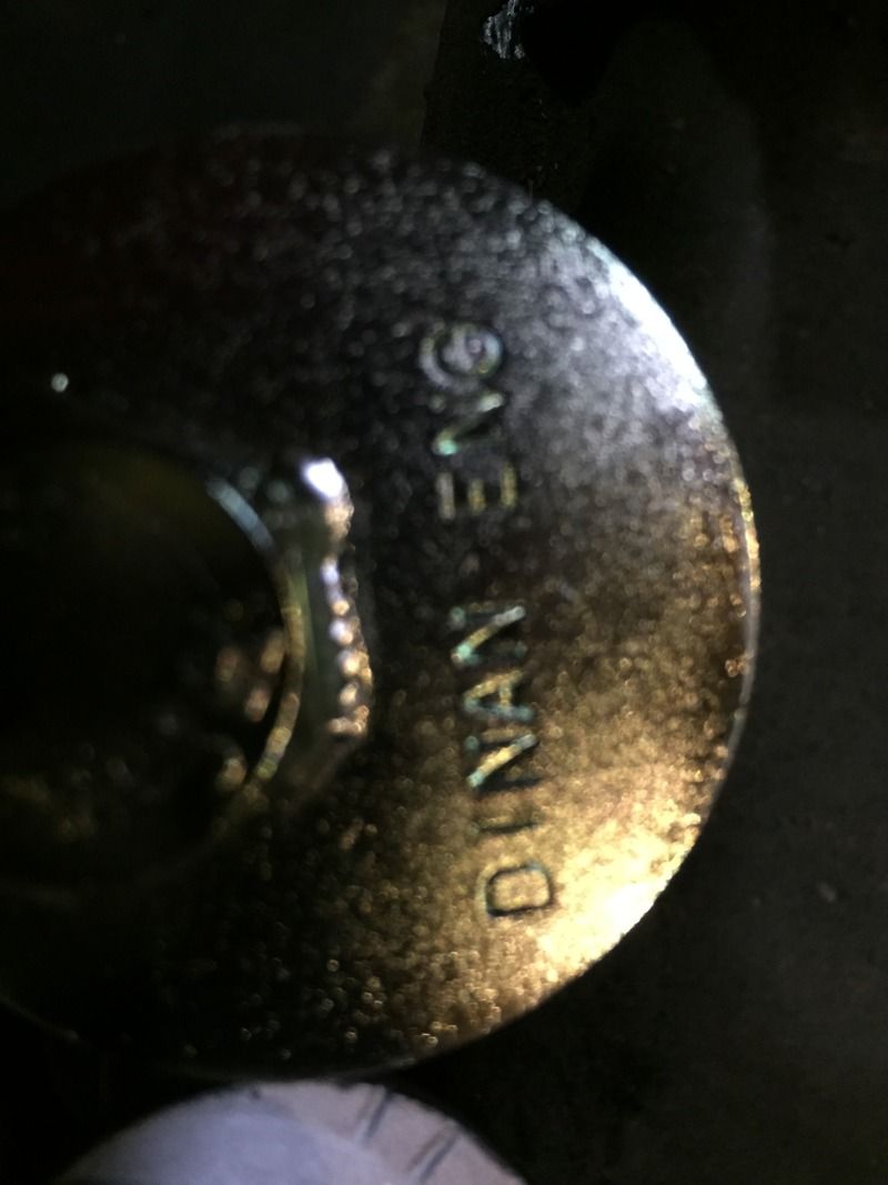

              Ive got a dinan rear subframe. It has some sort of hd bushings. Got it from robb@godspeed. He said it came out of a pro3 car. $600 takes it.
              • eurotrash
                • May 2007
                • 768
                The dinan compared to the 540 style alot of the other kits are modeled after. Makes fot more adjustment.
