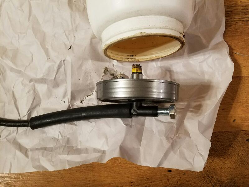

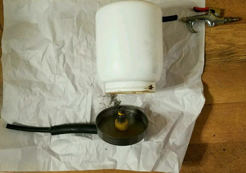

    Do you have access to compressed air? Just use a plastic jar and a cheap cigar. I have a setup ready except the cigar. Used it on the E46 and works great. Free to use.

                  Here is the general idea. May look more complicated than it needs to be. I just used parts I had laying around.
