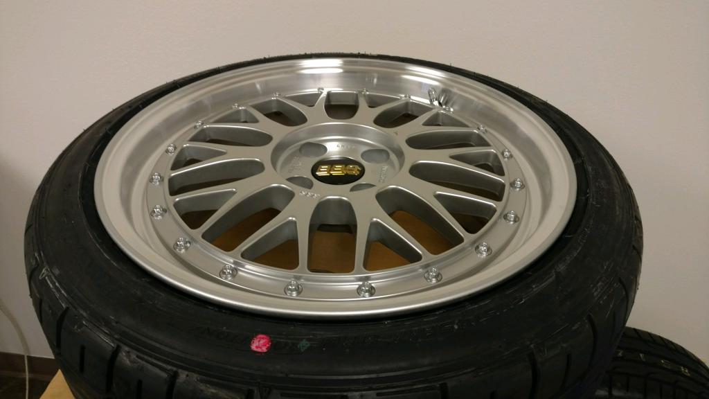

    Well I bought these BBS LM rims a couple of weeks ago of Craigslist( still on the fence about getting rid of my RS rims) so they are 7.5 X 17 ..4 on a 100, e30 fitment, 40mm offset... so I looked up the +3 on Tire Rack.. They listed a 205/45-17 fitment for a this car... I sure hope they were right... Tires came the other day... and I mounted them up... I'm note they are going to be correct.. The price was right for sure.. The car has Bilstein with H&R springs.. I lowered the car some... not whole lot in my book... Thank you for any advice..

    yea 205 45 16, and 17 is what a lot if not most people run
    you wont have any issues, i run 205 45 16 on my e30, and have had 0 issues

      45 is too tall of a side profile with a 17" wheel on an E30. You need a 205/40.

        im running a 205 40 on the e36 and bigger tires arrived today. its not much meat

          The Tire Rack showed 20/45-17 on +3... so I figured they would know what is correct... Guess I will need to bolt them up... and cross my fingers
          The BBS RS I have one running a 205/55-15...hmm... think I will be ok then ?

            It really depends on the offset of the wheels, ride height, stiffness of suspension, etc. Most likely, you will be ok, but through corners, it may catch the fender. I would have played it safe with a 40 profile, but you've already got tires.

                40 mm off set

                  Probably need 18mm spacers with those.

                    205s are too narrow on a 7.5" wheel IMO, they looked stretched. 215 would be better and I'd even run a 225.
                    A 205/45-15 is closer to stock than a 205/40-15, but only by a difference of 1% (+1.2% compared to -2.1%).
                    215/40-17 or 225/40-17 would also be very close to stock, but you might rub inside the fender.

                        If they're really 40 offset, the front wheels will probably rub the struts. I'm on H&R race springs with e90 top hats.
                        On here, the orange is what I have and I clear the wheel and strut by 1-2mm and the tires never rub.

                              205/45-17 is a correct diameter tire. A bit narrow for those wheels, but workable.
                              You're going to need spacers to make that wheel offset work, however. Figure 10-15mm for a stockish type look.
