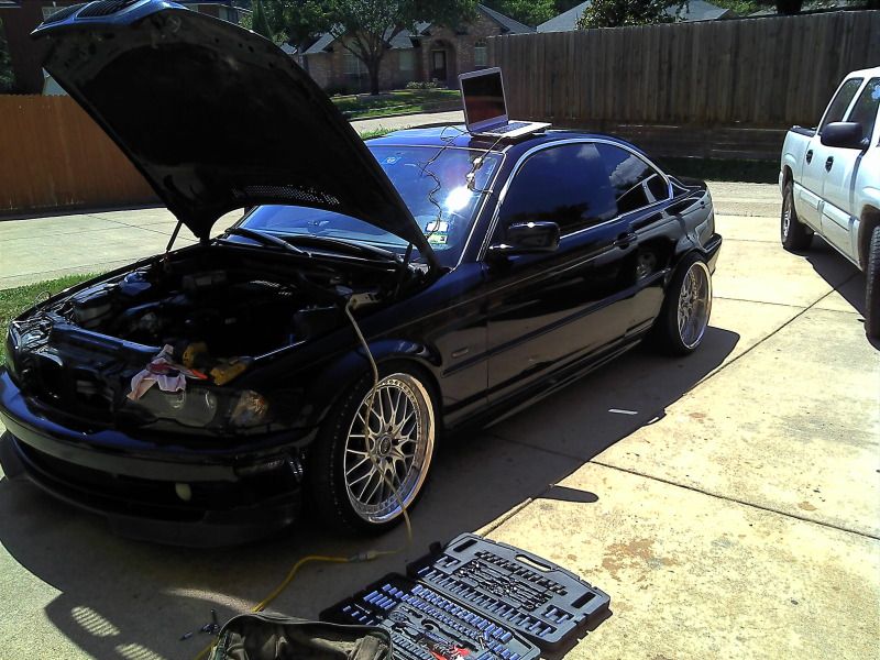

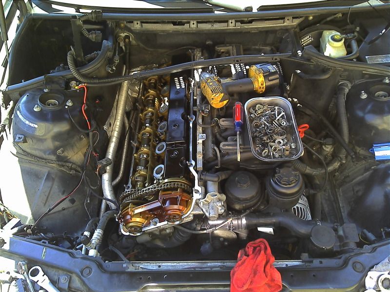

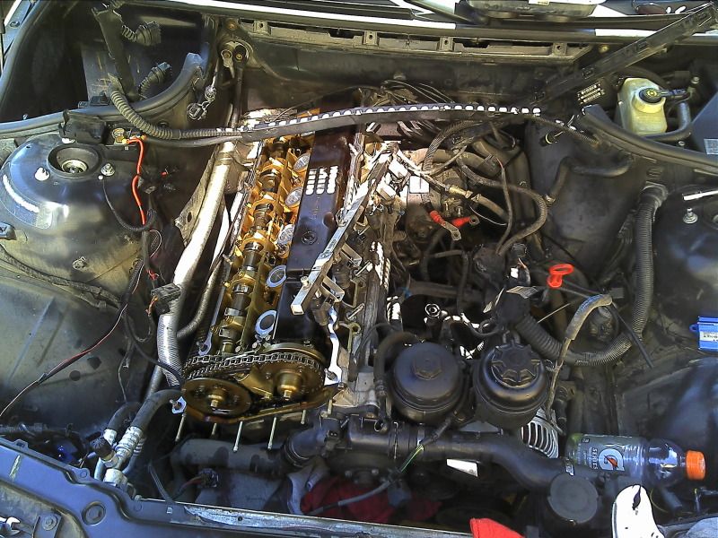

        Vanos, vcg, intake manifold swap, 330 throttle body, new control arm bushings, eu2 tune.

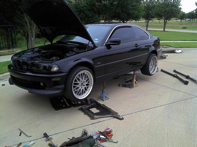

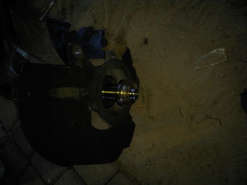

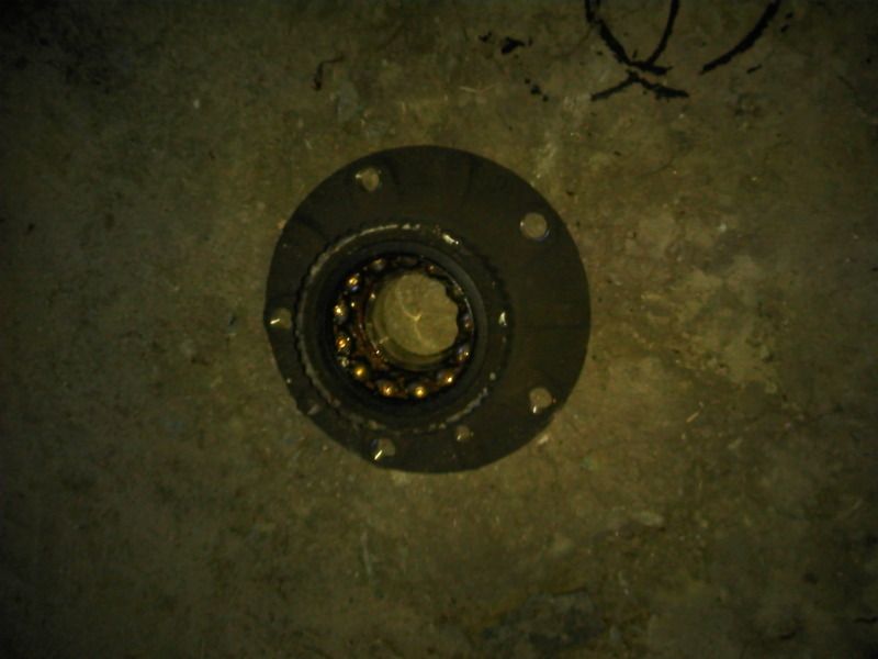

          Topic today. Saving lives lol. I took the knuckle off and dropped it on the floor, the bearing separated from the rest of it. Just fell out.
          Today new control arms, cab, and rear fender roll, also drivers side knuckle and bearing, with new tie rod.

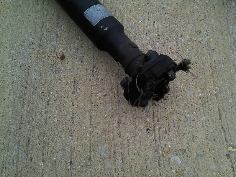

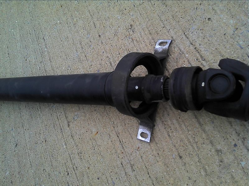

            replaced the bad throttle body that i installed on day 1, replaced a MESSED up guibo, and center support bearing (just replaced the whole drive shaft cause got it for a super deal) also replaced a bad o2 senor and plugged them in correctly, the place that the headers were installed at plugged number one plug into number 2 sensor.

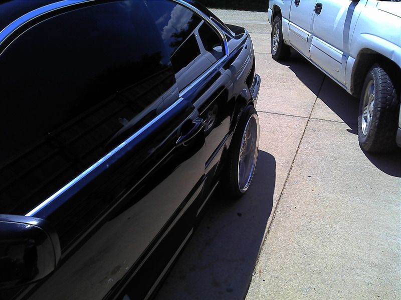

            Just some fender rolling
